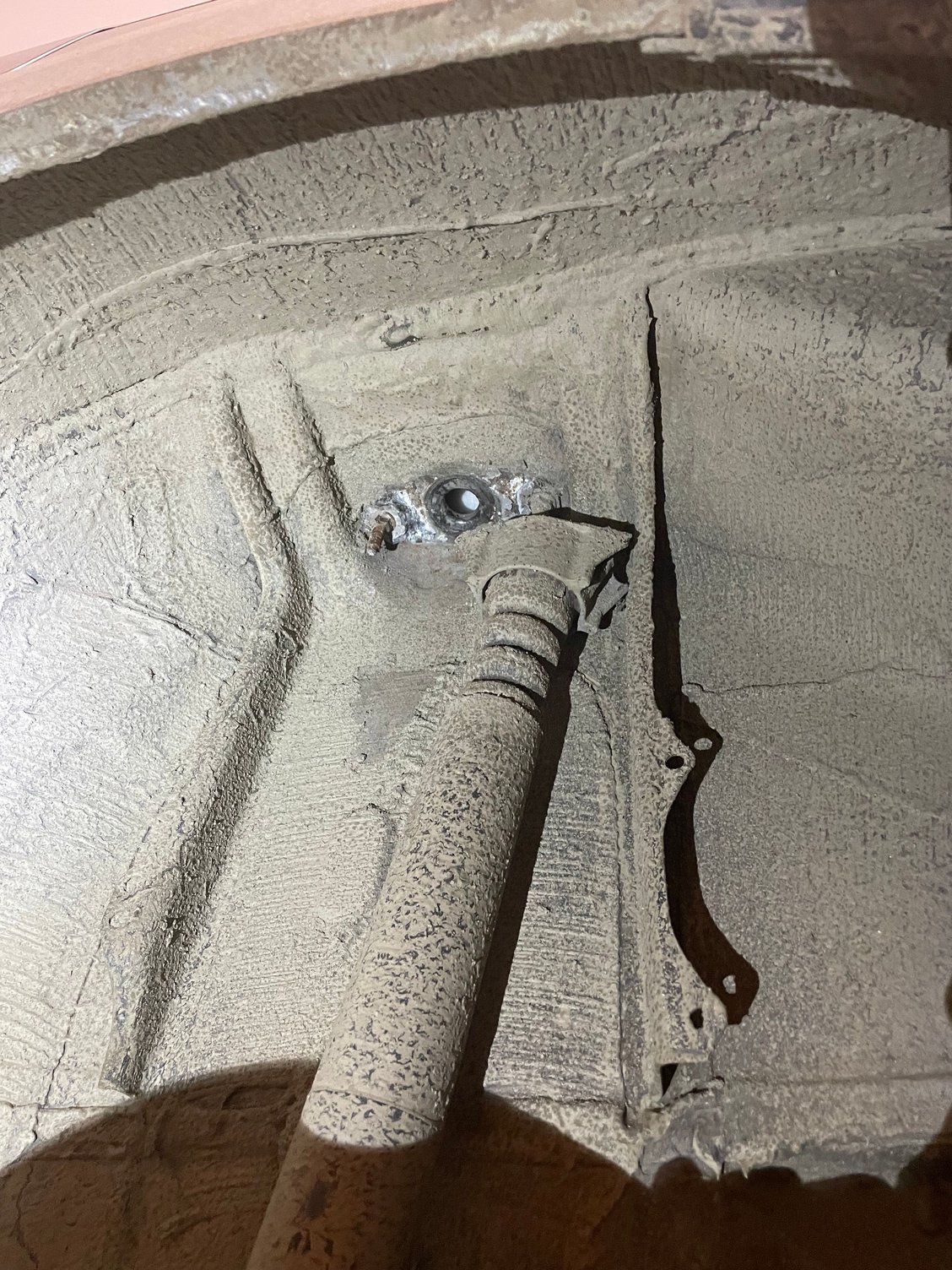

Well, as life would happen, I didn’t get the springs installed before Thanksgiving. In fact, they are in a box in my hallway giving me a look once in a while. On the brighter side, we didn’t actually load up the 5 and head out for Thanksgiving, so the car hasn’t been overloaded again, yet.
On the other hand, we did have an upper shock mount shatter, necessitating a quick change. Along with one bolt shearing off and having to be drilled out, etc. But I digress…
I am on the cusp of ordering new rear shocks and replacing the sway bar. I have located rear bars on MazdaSpeed3’s. What year would be optimal for my 2010 Mz5? I lean towards the ‘12 bar, along with new sway bar end links.
For shocks I am leaning towards the Volvo S50 Bilsteins. Does anyone have experience with them on their 5?
Thanks again for any input!
As an aside, I was somewhat disheartened by the amount of rust up there when I was repairing the shock mount. Sigh……
Well, now there’s your problem. The phone call was “heard a big clunk. Then a rattling noise.”
Finally, is there an inner wheel wheel cover made of plastic that is missing on my 5? Looks like there could/should be a wheel well liner of some sort in there.
