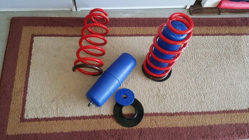

The air bags will NOT leak if installed correctly. I recomend the
Firestone "Coil-Rite" Air Bag Helper Springs
You may not find a listing for the MADZA
These are what I have used on a few none applicated rear coil spring car and currently a set will be going on my 2018 Mazda 3.
Firestone 4100 Coil-Rite Air Springs - 4100
https://www.mazdaforum.com/forum/maz...like-do-44018/
My Mazda 3 rear coil springs with the Firestone bags

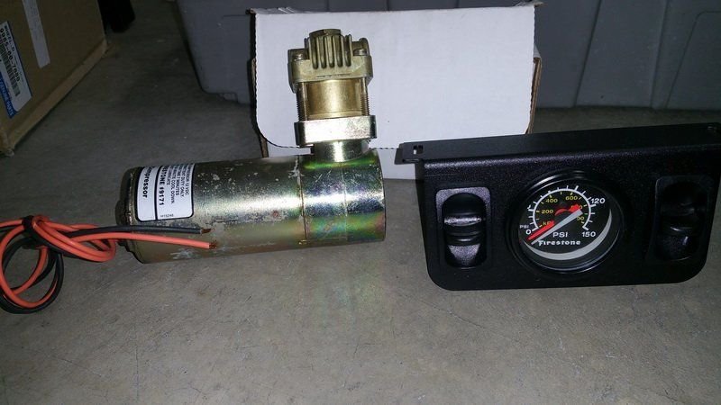

The air controller,air pump and gauge are from other Firestone misc parts I have and will be using with the universal Firestone Coil-Rite kit.
This is also a DUAL-AIR CONTROLLER to allow for separate air pressure adjustments in each bag.

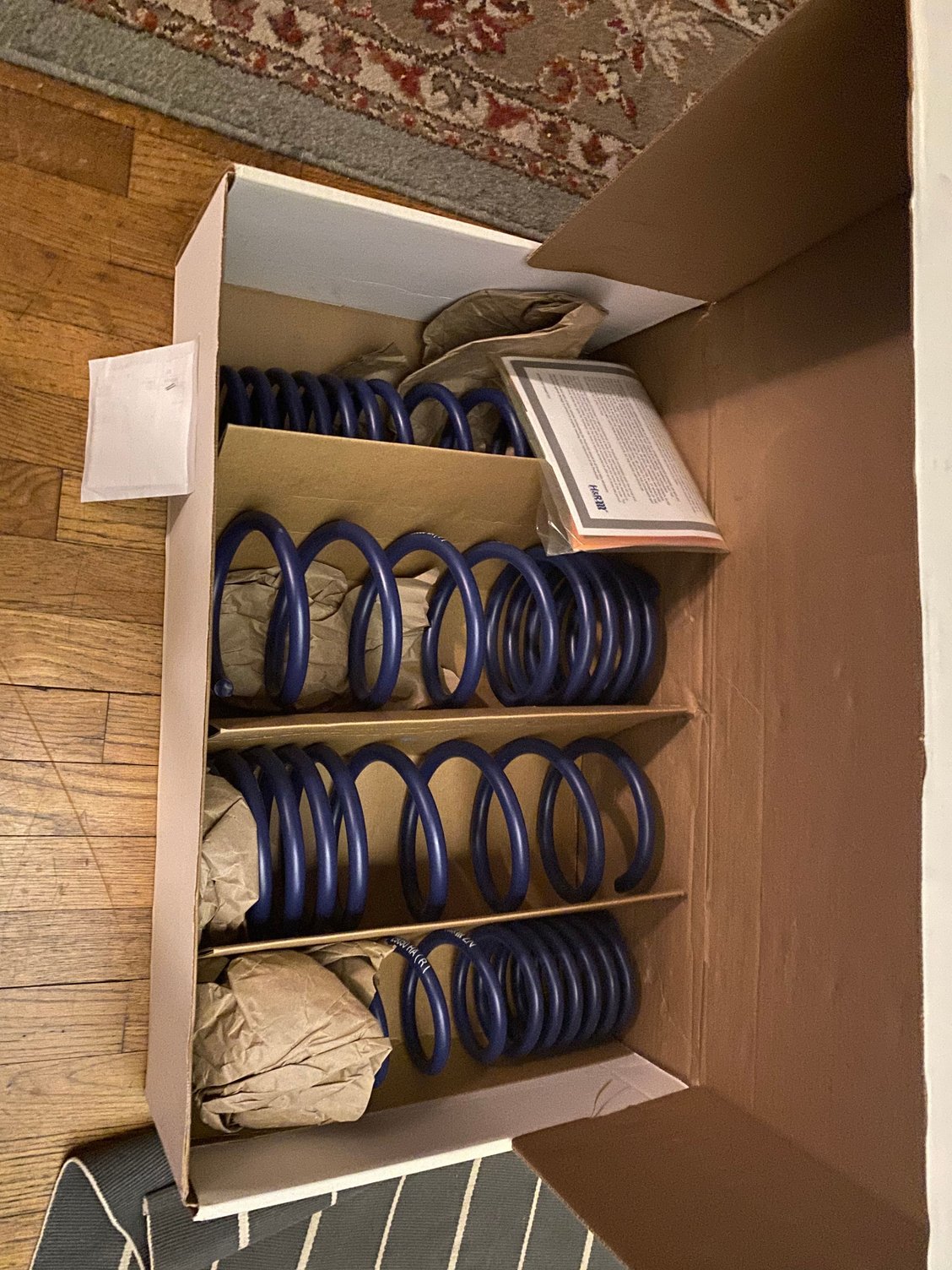

H&R springs arrived this afternoon. New shocks should be here on Tuesday. Quick measure of the rear springs is 14” long. I’ll compare them to the stock springs when they come out.
