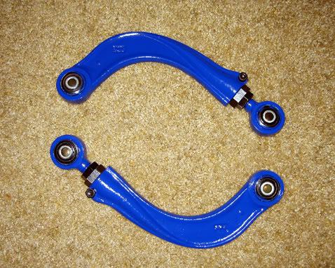

As far as a camber kit... you probably won't need one, but if like me you're more comfortable w/the added adjustment, consider the SPC's. I got mine cheap from someone selling out on eBay (in other words I got lucky. Right place, right time,) but have seen them for< $200 elsewhere. Unlike the MazdaSpeed links, the SPC's have anadjustable link/eyelet on one end, like a tie rod end.
[center]
Size:  81.4 KB[center]
They came black. I painted them blue to match my other suspension/brake components
