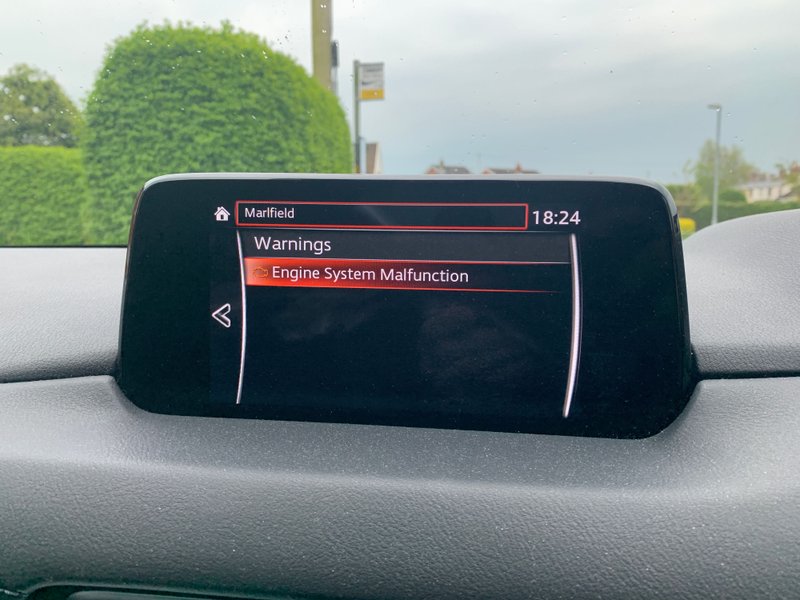

Patient: Mazda CX-5 2.2d Sport Nav+ Auto, 2019 year (Reg 68 - end of 2018)
My Mazda gone literally crazy. It started from Engine System Malfunction some time ago and then everything else was started adding up day by day.
Of course car was washed and all windscreen sensors and front logo one are clean.
So at the moment I have problems like those listed below divided on errors and behaviours.
ERRORS:
  • Engine System Malfunction
  • Brake override sys.malfunction
  • MRCC Malfunction (Mazda Radar Cruise Control)
  • Parking brake system malfunction
  • SCBS Malfunction (Smart City Brake Support)
  • SBS Malfunction (Smart City brake)
BEHAVIOURS:
  • Gears are not changing properly too long stays on the gear
  • front wiper won’t turn off if it is in auto mode and no rain (should switch off automatically)
  • when I park and leave the engine on I hear a clicking noise like a relay and the Start LED is blinking while I the click occurs. The same is when the engine is off but the dashboard is on.
  • when parking the distance beep indication is not working
What I noticed is that most of those problems are strictly related to all the sensors that are located behind the mirror on the windshield or behind the front Mazda logo and if they are not working probably automatically ESM (Engine System Malfunction) is thrown on the dashboard too, so:
All of those are strictly related as one relay on each other if algorithm have invalid data all other sensors thrown an errors. But what to check and how to diagnose which sensor could potentially develop a fault?
I have left it with mechanic but all he did was to reset all the errors and switching off the cruise control, and I must admit he did a brilliant job as entire dashboard was clean Until...
Until I've switched Cruise Control, after I did it all the errors are back on the dashboard.
WHAT I'VE CHECKED SO FAR:
- brake fluid level
- battery power after short test drive shows 12.3 (which is a bit low I guess, battery was never changed from new)
- a week ago MOT has been done, so we've replaced the rear break pads (front was replaced in November - new Brembo discs and pads fitted)
- all windscreen sensors and front logo ones are clean and free from dust
Here is a video of this clicking noise:
Noise when Engine is ON
Noise when Engine is OFF
And here are some pictures:
When the Cruise Control is switched OFF after restarting the engine only this ESM error stays as need reset probably.
Hope I can get some help from you guys as I'm literally going crazy about this car. We had a classic "Engine Oil is Too High" errors issues which are now gone, as we started to do more motorways miles and changing oil more frequently but now this...
I'm slowly starting to dislike Mazda as a brand and treating it as "reliable car" as many people thinks.
Thanks so much for your time guys...
