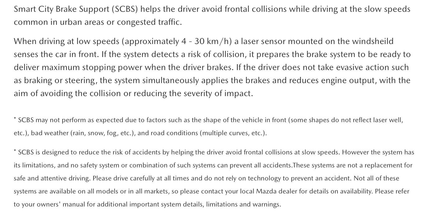

Have had a 2021 Signature 5 days and can't tell if Smart City Brake is working. Doesn't slow or stop the car in traffic at red lights, no warnings to brake. Adaptive cruise control works as expected. Am I missing something?

My SCBS works fine, in fact it activated on me this morning with a warning beep first - I was not using ACC at the time - when a car in front of me hit his brakes very hard when he almost missed his turn. A month ago it activated when it thought I was approaching a stopped car too quickly.
BTW the safe way to test it is to place a large empty cardboard box on the road. DO NOT test it approaching a real car!
