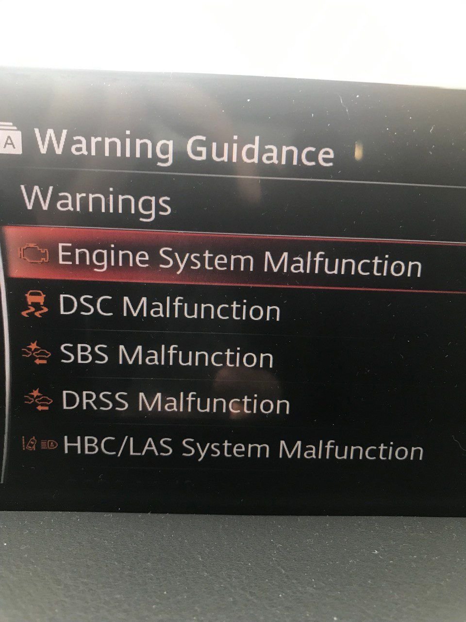

The story:
One cold snowy winter day, I noticed that the car would not turn off the engine. After some manipulations with P-R-D-P and Handbrake (electronic, btw) it stopped.
Sometimes gear shifter would not move to Parking.
Something seemed to be clicking in the area of ​​the gear shifter, and indicator in start/stop button a bit blinking. But after I've turned off 2nd Security System Tag it stopped, I think.
Errors (Warnings) appeared and almost always there:
- SBS Malfunction
- DRSS Malfunction
- DSC Malfunction
- SCBS Malfunction
Sometimes also with:
- Engine System Malfunction
- HBC/LAS System Malfunction
- Smart Brake System Malfunction
Also I've changed and later turned off 2nd Security System Tag battery.
Also turned off car battery for 15+ minutes.
Errors appeared again after drive (after 15-20 minutes, but could not disappear at all for some time).
Also first time I've noticed that stop lights blinking. Like alarm lights blinking, but that was definitely a stop lights.
Blink-Pause-Blink-Pause...
Turning off/on TCS helped. It happened few times.
In the service/dealer we replaced: BRAKE PEDAL STOP TAIL
Then Brake Override System Malfunction appeared as well. (maybe not related to replacement)
Start/stop button blinking orange while driving.
I know I need to take it to the service/dealer, but they doesn't know where to start searching. What would you advice?

Old Mar 5, 2023 | 04:37 AM
1st step is to scan it for fault codes.
Old Mar 5, 2023 | 05:20 AM
idia's Avatar
Joined: Mar 2023
From: Ukraine
Service man scanned but found nothing special. Most of codes will be same as errors in example.
