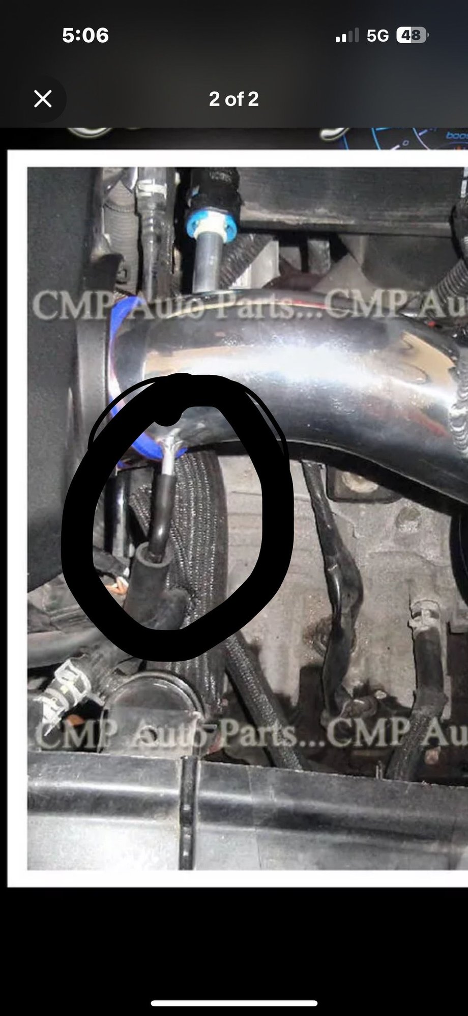

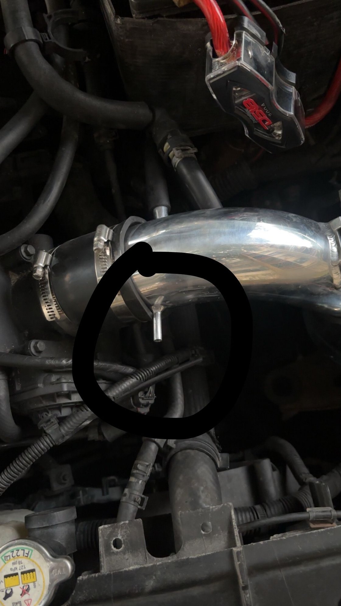

Hello, I have a 2007 Mazda 6I sedan. When I start it up it acts sluggish to start and then the traction light the TCS off light and the check engine light are on. I put a scanner and it reads a code. That is P0103. Which states that the mass or volume circuit is high. I looked it up and it says is the mass airflow sensor I ordered it but I realized that my aftermarket eBay intake has two open ports and I only have one hose connected. I just supposed to be two hoes connected. Am I missing one please let me know. I have attached the images of what I am talking about. Thank you in advance.

You have an aftermarket so called CAI. You should have first checked and confirmed that the mass airflow sensor had actually failed and not just needing to be cleaned both the sensors and the connector.
Because you have an un-named CAI I recommend that you go to the supplier where it came from and review their recommended installation for it which should include any and all hoses and sensors. You may have a problem if it was a UNIVERSAL CAI for how to correctly install the system replacing the factory air box.
Because it is universal they often have several hose and sensor adapter location so they fit many applications. The location you pictured are negative are pressure or for some would know it better as breather hose attachments.
One of the causes for sensor activation with a universal badly designed CAI is running several degrees hotter during (hence not a CAI intake) low % throttle position. So you part that you assumed to be bad may only be reporting the limits of the specification to the ECU.

Hello, thanks for the information. The CAI is specifically for the Mazda I didn’t buy a universal one. This came with the outlet for the sensor and everything and it did come with the hose but I never knew where it is supposed to be connected. I’ve seen videos and pictures on YouTube where some didn’t have the hose hooked up either but I guess that was just for the installation. I’ve had the CAI installed for about a month and I’m only now getting this issue. I have ordered a new premium Mass airflow sensor and should be here tomorrow so I’m hoping that’s the issue.

You need a Breather hose from the valve cover to the air filter tubing . If left open as not plugged, then you may have contaminated your MAS/MAP and also the IAT sensors'. Any hose before the Throttle body are negative air pressure not positive which is created after the throttle body. If not connected and left open then your PCV (positive crankcase) system can not work properly.

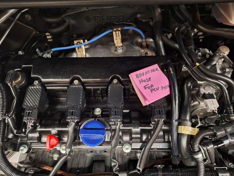

2006-2008 Mazda 6 Valve Cover - Genuine W0133-2733507 - - PartsGeek.com
See picture right side rear of valve cover.

Not sure what you are asking at this point, and you covered your intake tube so I technically cant confirm that it is connected correctly now?
2003-2013 Mazda 6 Breather Hose - Gates W0133-2455381 - - PartsGeek.com

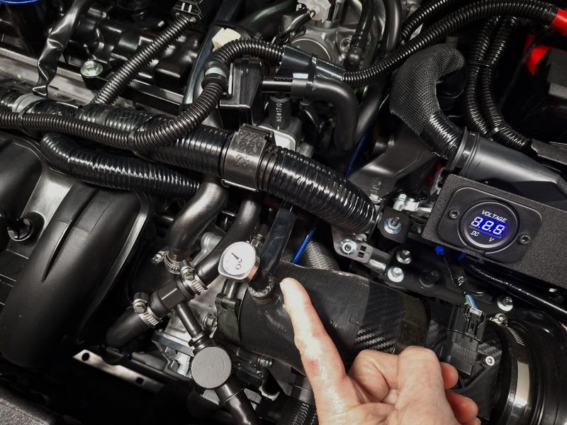

You sent a picture with just a sticky note saying what it says and the guy pointing at the connection But from the picture it looks like my engine bay is different. In the picture from the CAI that the guy bought and installed in the Mazda I have now it shows the hose running from the intake downwards not behind of the engine. I attached a video of what a video of an outlet I found down in that area so I was asking if you think this is the outlet the hose is supposed to be connected to. I will place the image but please view the video if you can.

The picture are of my engine. I made the post it for you. And the breather hose is fundamentally connecting the same on most all Mazda engine of this type. Specifically, Skyactiv. Don't try to look so into that my valve cover for the breather is in a l have sightly different location for the breather hose as you valve cover that is also why I posted actual replacement parts for your exact reference.
Because aftermarket air intake/filter kit maybe you should use this to find you exact hose location and where it may connect to your CAI or wait until you find the brand and hope they have an installation instruction to follow for you?
