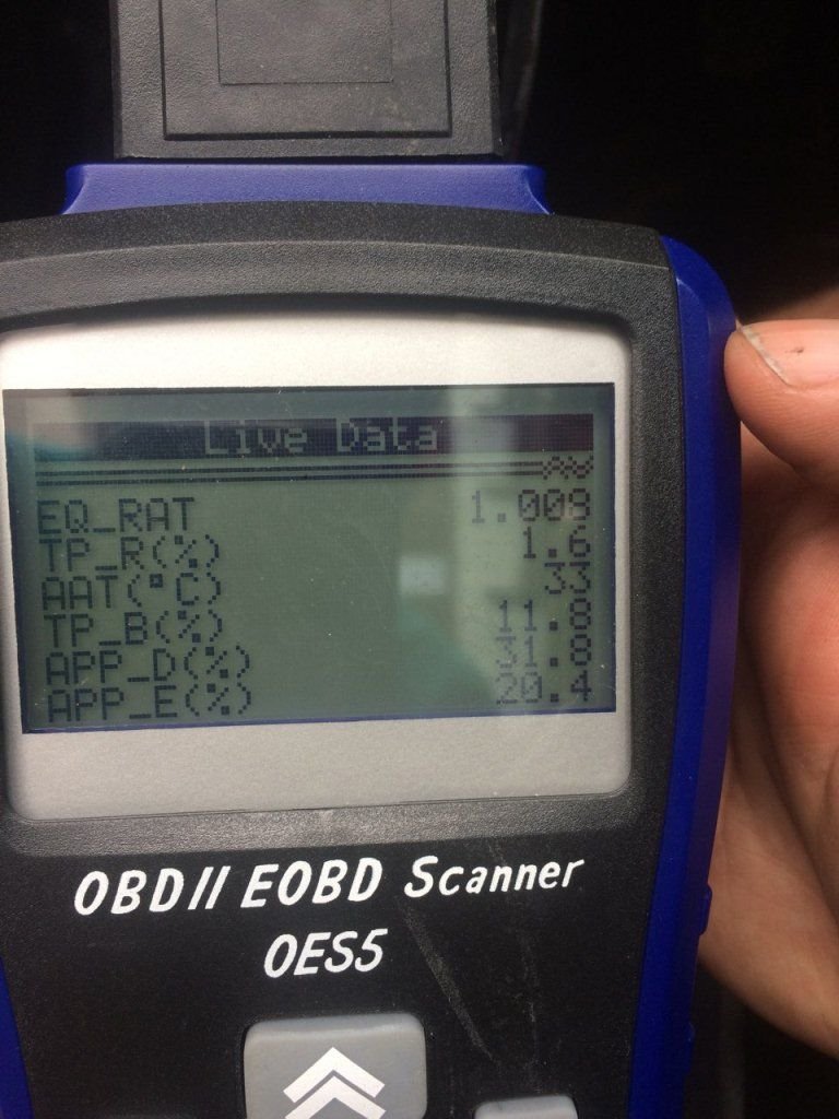

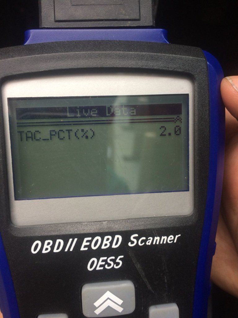

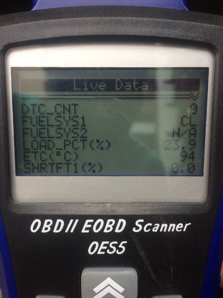

I have Mazda 6 2008 with an engine 2.3. 5 speed Manual Gearbox.
When I'm trying to accelerate, for me it seems like the car is a bit lazy - I mean the car accelerates slowly, but after The RPM reaches 4000 - then the acceleration gets much effective..I've connected the OBDII adapter and took the photos on the screen which shows the data of temperatures and maybe other datas also, which i don't understand. (by the way, there is no Check Engine light)
If anyone can help me, please.. please.. see the attached photos and advise if anything is wrong with the datas (numbers) and give some recommendations.
Thanks in Advance
