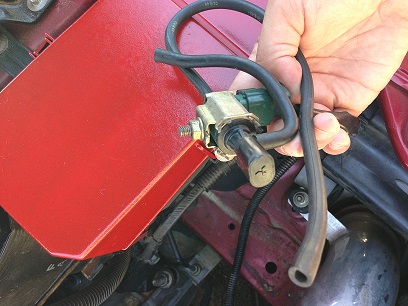

When i bought the car this was tucked into the fender

It's your electrical/vaccuum solenoid which was attached to the factory airbox. It was used to open up another intake flapper in the stock airbox for more air. I have attached a pic on it.
You must have an aftermarket installed. With aftermarket intakes this is not necessary, however you must still have it hanging around and it must be plugged in electrically! You should see there is an electrical plug in for it which is also green. Leave it plugged in and tie it up. Show us a pic of your intake.
I also included a pic with an aftermarket intake and you can see the green solenoid hanging around but still plugged in.
