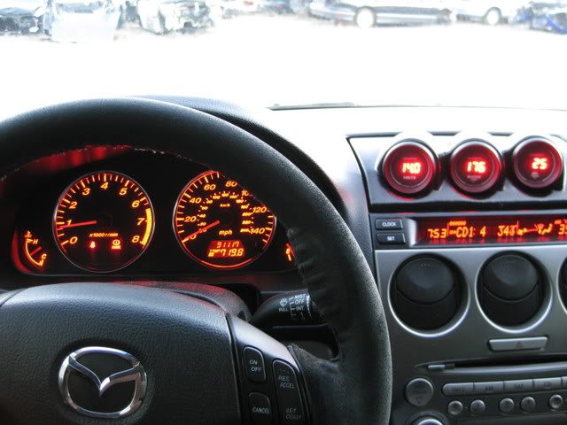

I have that same gauge pod with AutoMeter digital series gauges. Best gauge pod on the market for our cars.
-Sheldon.

Thanks Mazmart! If you got a pic I sure would like to see it. Also any tips on running the wires. The way I read it, there is a ready made conduit running down the center of the console. Is that where you ran the wires? I'm going to go electronic to avoid any hot fluids ending up inside the cabin. With my luck at plumbing, I'm sure to have a leak or two!
Old Mar 29, 2010 | 03:26 PM
Mazmart Trini's Avatar
Joined: Oct 2007
Posts: 909
From: Atlanta, Ga.
The pic of my setup is in Post #3.
-Sheldon.
