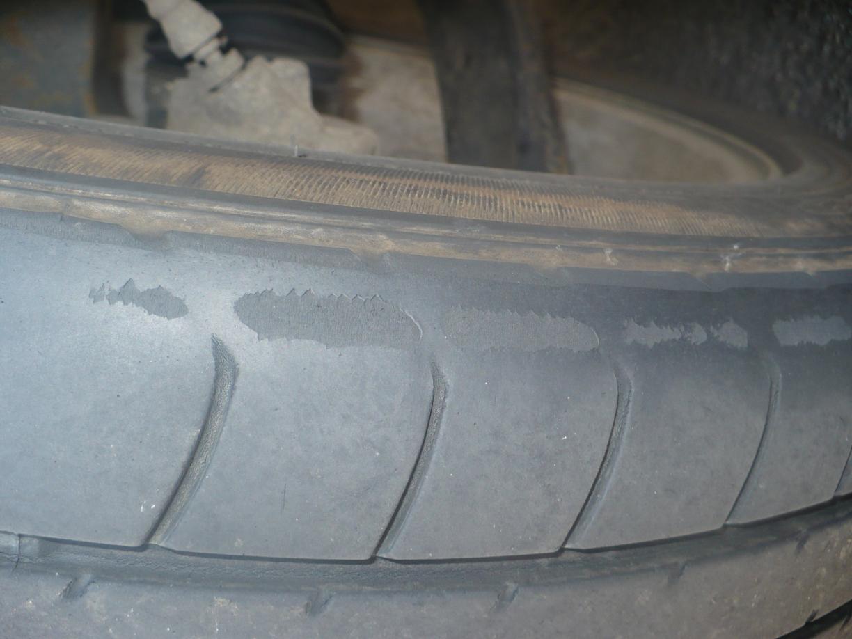

Beware .... measuring or monitoring the tread depth will not show up this issue/problem. You need to really look at the inside edge, turn your steering to full lock one way then the other and have a real good look at the inside edge.

I intend to get my front tyre (shown in previous picture) to Dunlop to be inspected/tested and a written report returned. I am hoping that they can confirm that it is most likely due to incorrect negative camber. Toe in & toe out (alignment) will be ruled out as there is no tell tail 'feathering'. That is when the edges of tread rise up like the tips of feathers. Also not over or under inflated.
Yes! You would expect that if Dunlop reinforced their tyre they would know and also their tyre markings would indicate it too. Also reinforcing it would not cure the problem of the camber. The only thing that would 'help' in this specific instance would be to have the inner edge made of a harder and tougher rubber, but that would detract from the performance. I have added an old picture of an old tyre with extreme camber wear. Bear in mind that this tyre is very old type/style, where as we have a modern type/style radial with a low profile. The image is of a car wheel from the era of the Ford Anglia, Austin Allegro etc from (60's to early 70's, both of which I've had).
