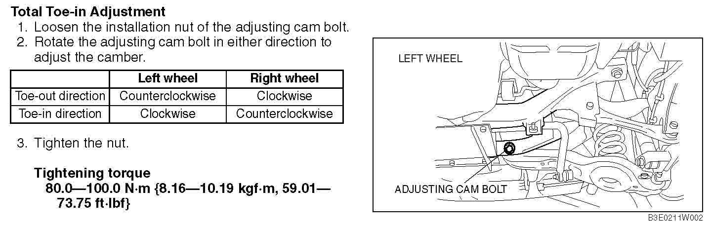

Rhodri... Some good observations there. To adjust toe (though at the rear it is not really Toe because if it needs adjusting it is because of component wear or 'crash damage' and actually need replacement components) and camber at the rear (see doc I will add in time, seriously edited to fit here) which is adjusted via a cam bolt you can see with graduations on if you look underneath the rear of your Mazda 5. My spigots are in the same positions as your diesel on top of front strut/shockers and is painted blue too, I have the petrol car. But beware that there are different values for petrol and diesel versions of the UK Sport (let alone major differences to USA/Canadian version etc.). I'd like to suggest that we keep this thread for the 2 UK Sport versions please?

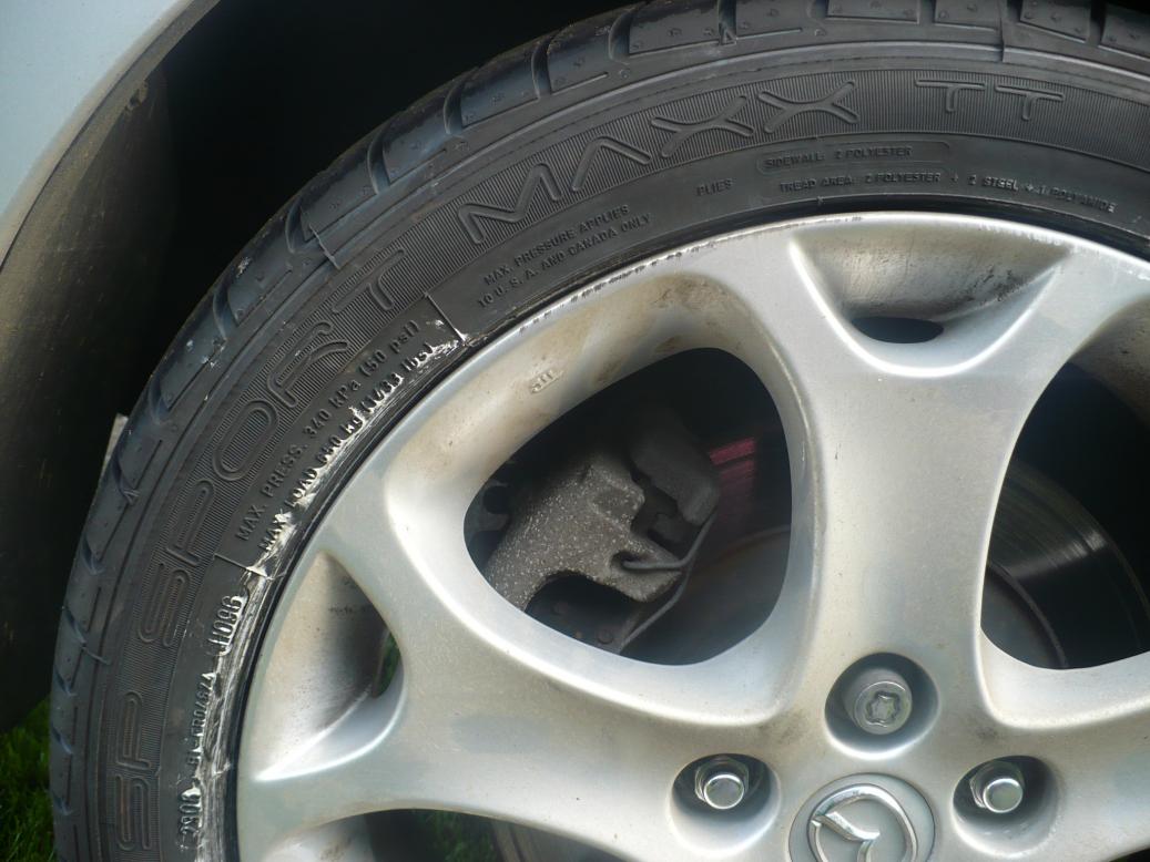

It is so clear from our symptoms on this issue that our front tyre wear problem is negative CAMBER, for the reasons I have suggested about 17" on a 15" wheel design.
By the way if you are stopped by police and the wear (down to 'canvas' on the inside edge in our case) on your tyres is spotted or you have an accident that involves police or insurance and they wish to pursue the matter you will find your insurance invalidated, a £2500 fine and 3 points for each tyre found with 'fault'. Bare that in mind when writing to Mazda to complain about the risk they are taking with your lives in their cars with this front tyre wear issue.

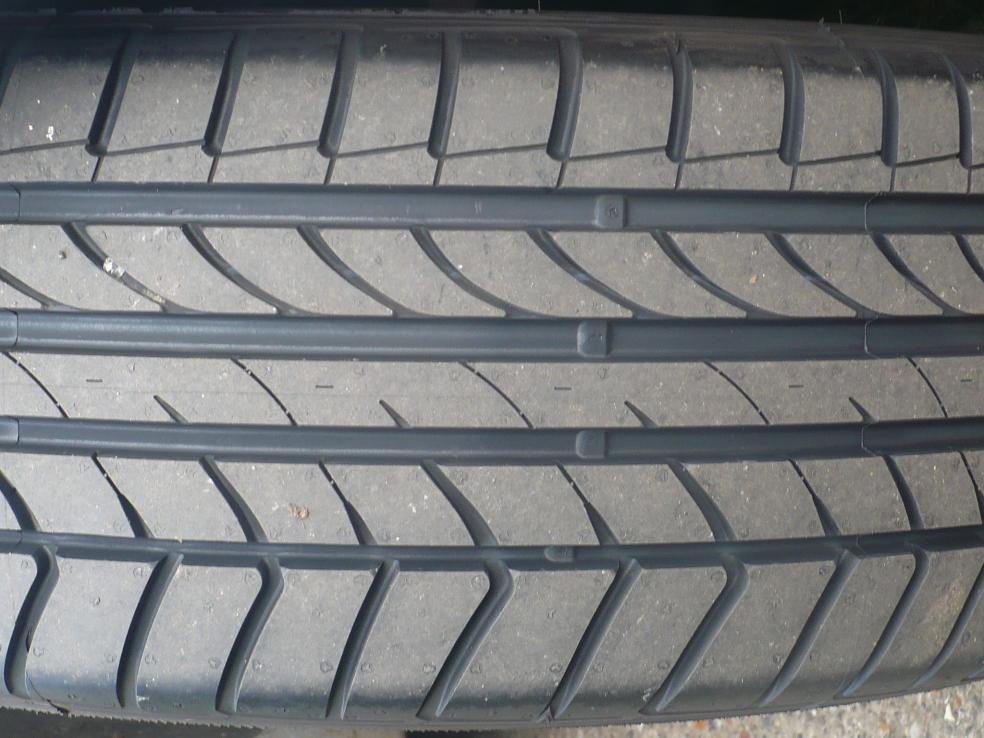

I agree with you about it being a camber issue. To try and get some idea of how my camber was set on my car I put a thin coat of grease on sheets of paper and then slowly ran my car over them to see the tread pattern. I compared rear and front in both full lock positions as well as straight ahead. Hardly a scientific way of doing it I know but it did appear on balance that the greater tread pattern was on the outside i.e. opposite the where the wear is taking place. This would suggest my camber setting is slightly positive. Against this is the fact that the area where the tyre is worn will not create a tread pattern at the near static test speed. So on balance I decided the result could not be considered conclusive.
I also repeated the test comparing tyres with pressures at 38psi compared with 33psi. Again nothing conclusive was evident.
Another thing I tried - I increased the front tyres pressure to 38psi. I put a test patch of white paint on the worn area to see how quickly it was being wornaway.
After about 5miles all traces of paint had disappeared from the worn area. Again not very scientific but it would suggest that simply increasing tyre pressures will do little to solve the problem.
I have also been giving some thought to the issue of settings for 16" v 17" wheels. I would have assumed the overall diameter of wheel and tyre should be near enough the same in both cases. Is this right? I am not quite sure how the 50 v 55 aspect ratio of the different tyres translates into mm or inches on the overall diameter. Can anyone give me a figure? If the overall difference is only a few mm then it may be the settings will be the same in both cases. I suppose the designers are more interested in the wheel/tyre radius rather than diameter as it will be this distance that goes into their calculations. Any differences in overall diameter between 16 and 17 wheel/tyre combinations would therefore be halved as far as the designer is concerned. Add in the fact that a worn tyre will have a radius of about 5mm less than a new one and a further degree of variation is introduced.
Does all this make sense? It does not allow for any design factors arising due to the same cornering thrust being applied to tyres with 50 v 55 aspect ratios. So far my brain has not been able to come up with any theories on this.

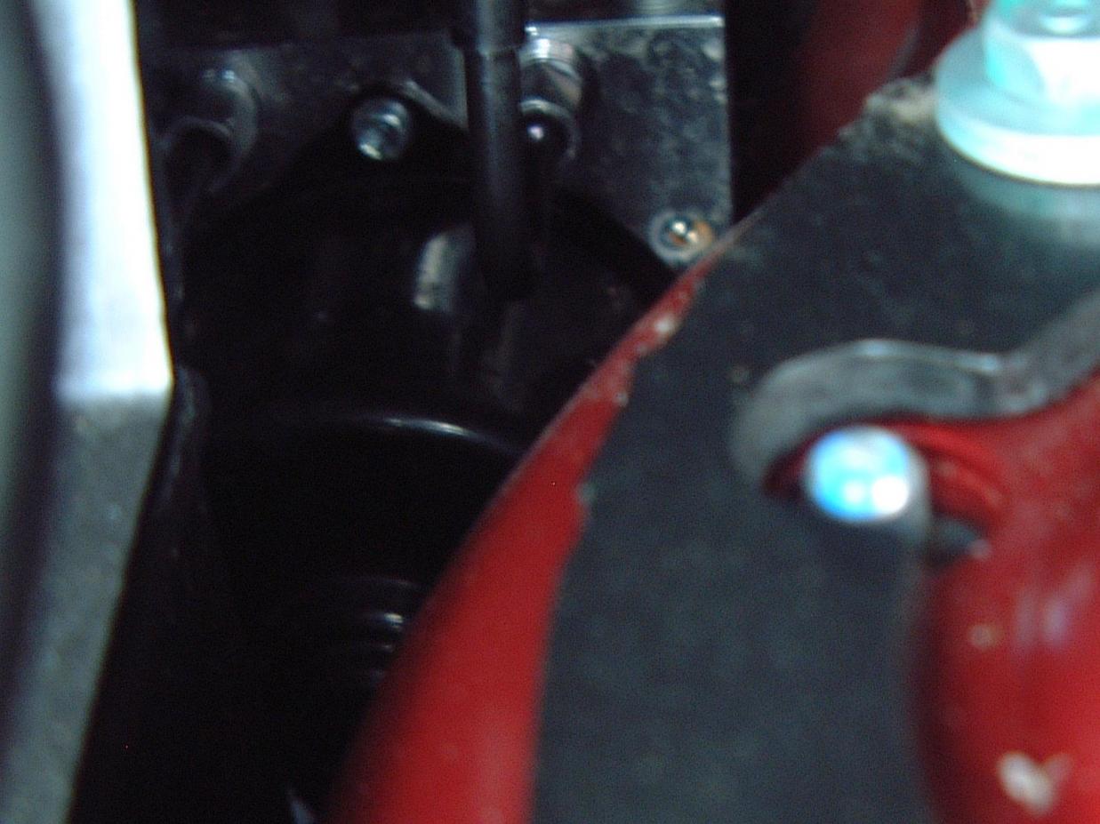

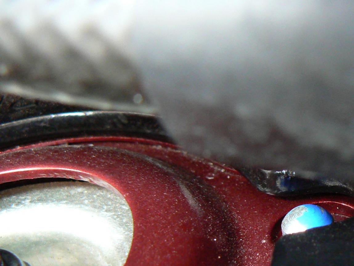

I will attach some pics of the strut tops and "markings" for toe on the rear shortly which correspond to the measurements below.

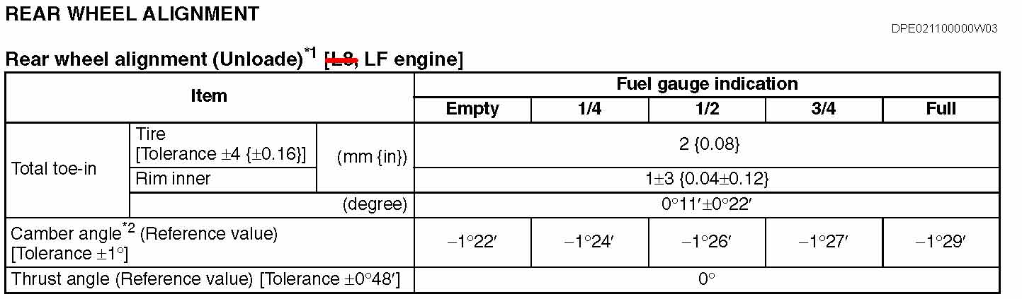

The dealers recommended settings are: 1mm toe in each side at the front, 1.5mm toe in each side at the rear. No reference to camber.
This is what my car is now set to. Interstingly the rear markers point in the same direction even though both wheels are toe in. I would have thought they were handed.
The camber was measured not adjusted at the following values (sorry for the mixed units but this is what the printout says):
NSF -1 degree .4
OSF -0 degree .4
NSR -1 degree .6
OSR -1 degree .3
Please feel free to comment.
