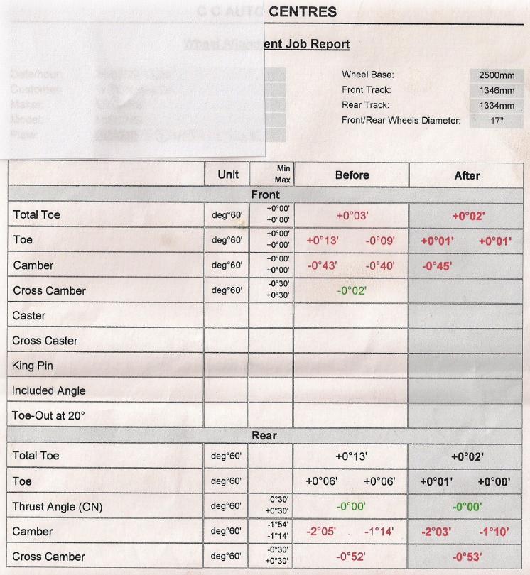

Hi guys..
I had my mazda5 4 wheel aligned yesterday at the request of my dealers my car as coverd only 7600 miles in 2 years and the front inner tyres are bald, Cost me £60 got a report cant tell head nor tale of it can anybody tell weather the alignmemt was out and weather it as been ajusted to the correct setting many thanks in advance...
P.S. What are the correct settings?
