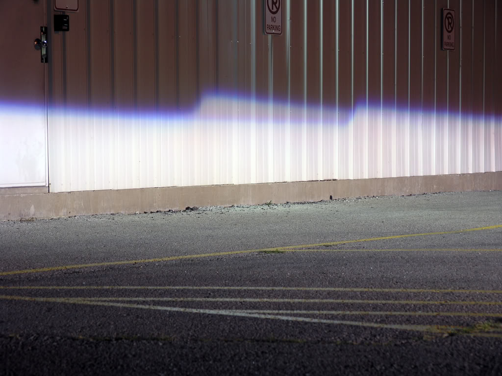

Stock Xenon ds2
Stock Xenon ds2

Wow, I wish I accidentally found out I had OEM HIDs. lol
The OEM HIDs are 35w ~4,100k lamps. 4,100-4,300 provide the brightest and most usable light. Anything above that moves towards the blue end of the spectrum. The higher output of 55w lamps tend to wash out that effect somewhat, so a 8,000k 55w will look akin to a 6,000 35w.
As far as brightness you can replace the OEM ballast with a 55w ballast if you want. You can either buy a set of 55w ballasts or you can keep your 55w kit, get 55w D2S lamps and then get a different harness that will connect to the D2S lamps (since your kit came with a H7 harness.
Before messing with that though I'm going to suggest something else. If you replace the lens on your projectors with a clear lens (I realize the stock lens looks clear but it's actually frosted) and space the lens from the shield then you'll get better output and lots of that pretty blue along the cutoff. That way you can stick with the highest lumen output color temp. and get that pretty blue cutoff that you see on higher end cars. Yes that involves removing the headlamps, opening the lights and putting in new lenses...... it's really not that hard.
As far as lamps go if you really want to get the best brightest light I recommend looking for Phillips 85112+ D2S lamps. They're arguably the best lamps available.
To answer your other question, yes it is possible to replace the lamps without removing the bumper and the housings, however there's so little space to work with that it can actually be easier to just remove the bumper cover. Doing so takes less than 10 minutes so it's not that much of a chore and can save a great deal of frustration.
If you want to learn more about HIDs, modifications, etc. then I'm happy to help. I also recommend spending some time looking around HiDplanet : The Official Automotive Lighting Forum - The Buzz.
