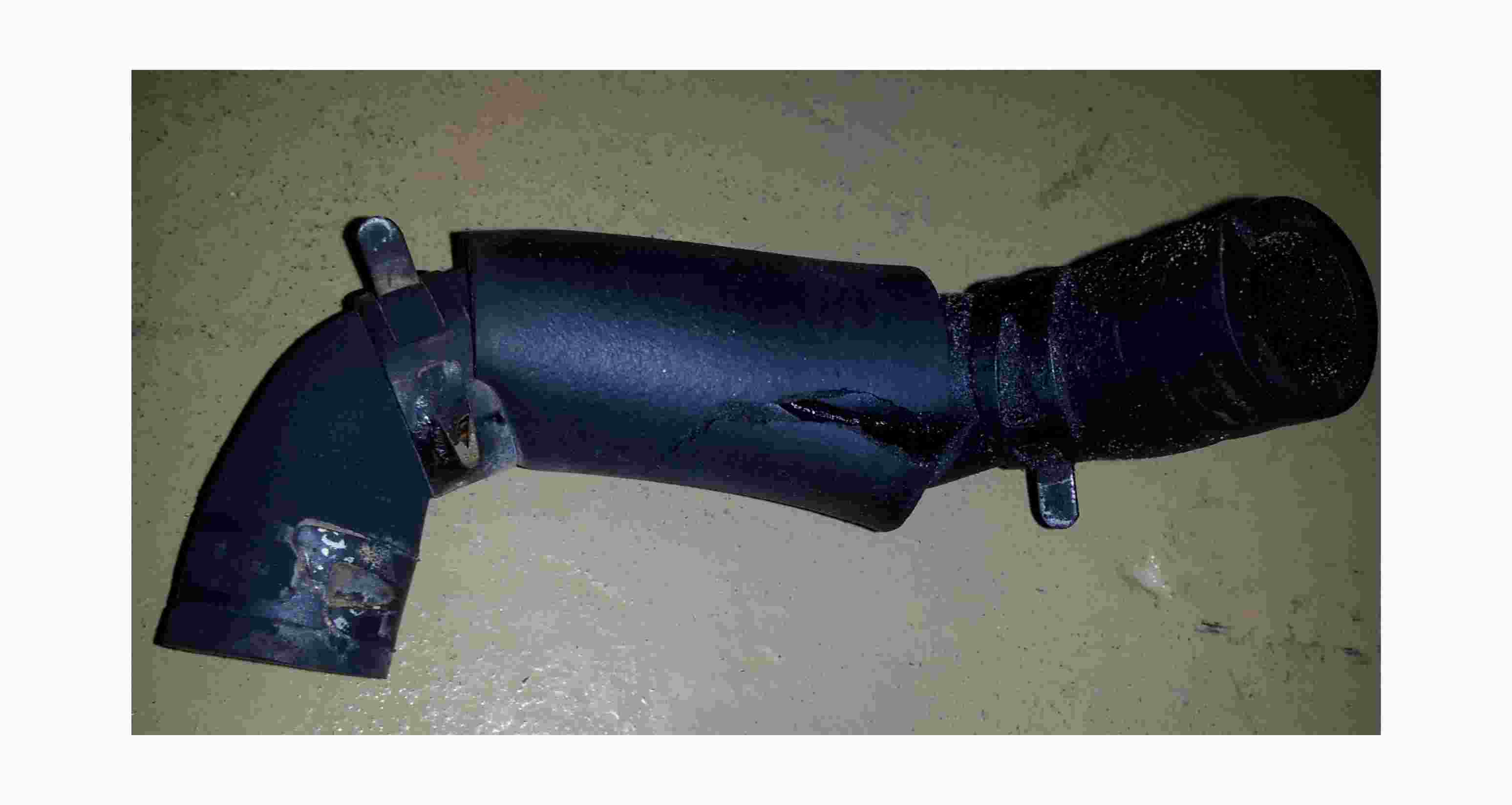

The link below to Luchboxx's post on the intake removal was invaluable. Thank you lunchboxx!!! He is right, the Haynes manual $u(k$ when it comes to the intake removal.
The PCV valve tube was the culprit. I changed the Intake gaskets while I had the intake off of course. Test driven and all is quiet. If I were able to see the PCV Valve tube before I started it may have saved a few hours. I think it is possible to get to it by taking the starter off instead.
FYI the dealer wanted $67 for the new tube, got it from AutoZone in 1 day for only $26 (O'Reillys also was able to get it for $26 but it would take 5-7 days). AutoZone did not have a listing for it under the Tribute. So I had to order it for a 2009 Ford Fusion (same part# 46034).
Thanks again MazdaTirol and TanProtege.
