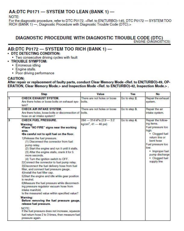

Thanks ... I hope the problem is for vacuum leak and maybe the leak is very very small and its hard to see and where it is ...
my friend gave me the picture and I attached it so what do you think ? ... its for Mazda factory ....

The only way to check it was the way i suggested, by pinching off the line and monitoring the data!
