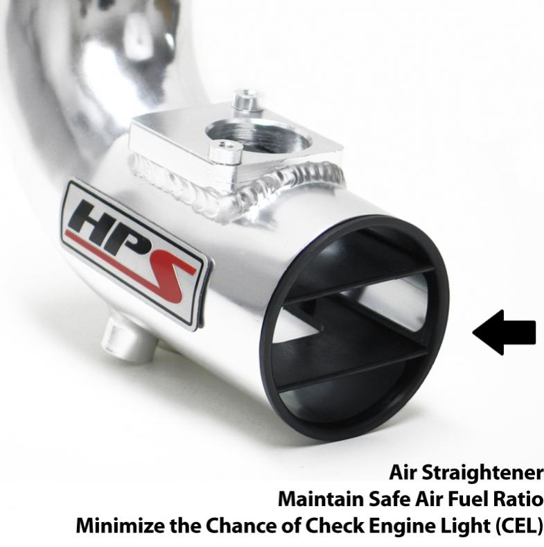

Whats air straighter ? I think there is no leaking and air goes through MAF sensor and no air entering the system ... the car drives perfect and no problem but I wanna turn off the light and I wanna know the problem ....
Click on the link and scroll down a bit. It basically narrows your intake to where it should be and straightens the air so it goes through MAF properly. Some aftermarket intakes throw a cel due to the wrong position or thicker diameter intake.
AIR STRAIGHTENER: 2 Pics (1 as an attachment)
