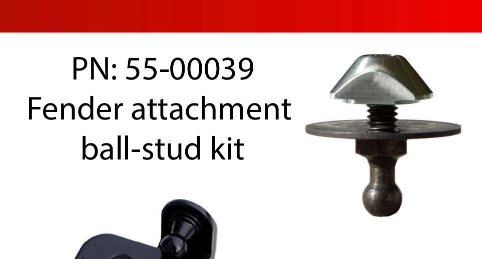

Were the fender washers black and did they come with the kit?
Old Mar 26, 2021 | 04:28 PM
  #34
GregP74's Avatar
Joined: Dec 2020
Posts: 159
From: Cherry Valley, IL
It comes with a pair of these doo-dads. You angle the wedge shaped part through the large opening in the fender then align it so the little raised portion is centered in the hole. They tell you to tighten it by hand before using a 3/8 deep socket to get it tighter. I had no problems at all with the passenger side although the drivers side one wanted to spin around on me at first. (The pic of it is upside down, ball end goes on top.)
Old Mar 26, 2021 | 04:44 PM
  #35
Dennis Wendt's Avatar
Joined: May 2020
Posts: 393
Likes: 1
From: Central Wisconsin
OK. Used the big hole instead. Thank you.
