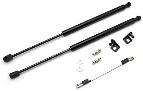

These kits are NOT all the same. The gas struts in most kits are low quality and will fail when you least expect it. But good news you can easily replace them with high quality struts. Also many of the bargain kits found on ebay and amazon come with standard fasteners that have little or no coating to prevent rust or corrosion. You may also need to replace them at some point depending on where you live?
That is something I wondered about. Maybe it'd be a good idea just to get some quality struts to put on there to begin with. As far as the fasteners do you mean the clips on the ends of the struts?

Lift Support Depot and *Strong Arm are two very good quality manufactures of strut supports . There is universal sizing chart to get the correct size part number.
Fasteners like nuts bolts washers etc. If needed not all kits require anything except the ball and clip which is what it is. Most upgraded nots and bolts if needed you can get at your local Lowes or Home depot look for stainless steel. (yes I know they are not hospital grade SS).

Gotcha. If I'm going to do this thing I may as well do it right the first time and not use junky parts.
It looks like on Lift Supports Depot the struts come with hardware on the ends.
The kit shows the ***** for the bottom that screw in, but it looks like the fasteners for the bottom come on that little tool they include. Not sure about the quality of those. The ***** for the top thing are shown already attached to the mounting bracket I suspect they'd be removable. (I'd actually be tempted, if possible to use something with an eyelet hole but that may not really be doable.)

I think you will be ok? These are simple to install and if a strut goes bad , replace them at that time with good quality units .
You will know when one start to go the day you open the hood and it slowy closes down while you are working on your engine. LOL
A few of us have had that happen and in the old day when some of us were poor we just carried a broom stick cut to the right length. LOL
