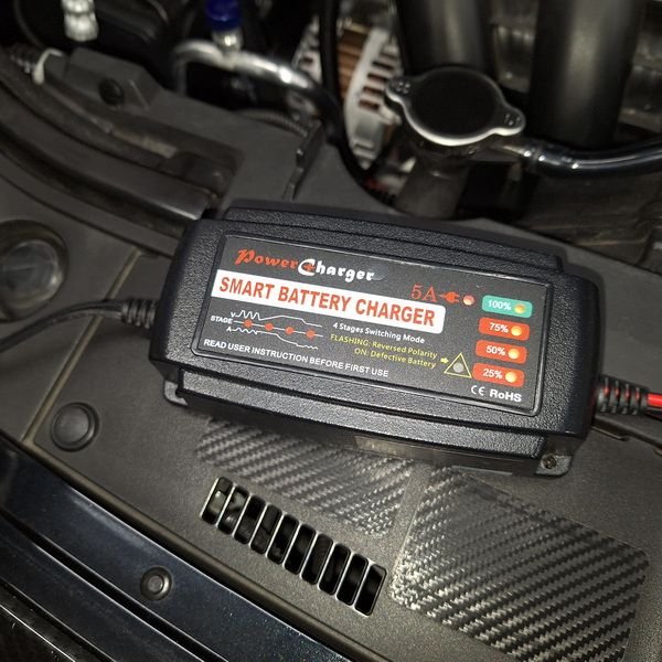

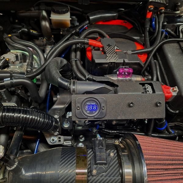

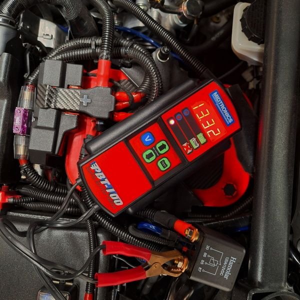

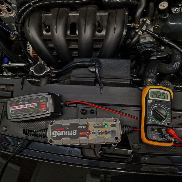

I know of very few people that take as good a care to their charging system and their battery as I do. Yet here is a perfect example of my Mazda that get monitored and charged daily, starts fine and give no indication of any problems. the OPTIMA is now load test as failing a load test. This means based on a comment like we often see " my battery starts fine and gives me no trouble" yet I know that I need to get a new battery ASAP because I could go out start my Mazda run up to the store come back out and the engine will not start. It happens that fast!
So I guess i have to thank this forum and this thread to have me post what I thought was going to be an example of HOW_TO check and charge a battery to me finding out since last month when I load tested my own battery and it was good is now failing. My records show I last test Dec 3 2023.
I started out only to wanting show the use of my Ginisus as well my inexpensive daily brand Power Charger I use. Now I am ordering a new battery.
