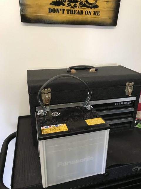

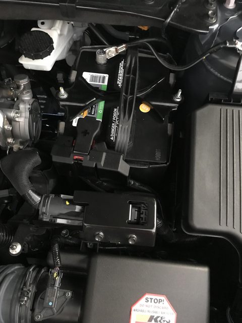

Idecided to Replaced Battery Today with a Walmart Everstart Maxx, Group 35, 640 CCA,. $139.84
After removing cables & hold down clamp, I removed insulation sleeve, made it easier to lift battery up and out. I also used a 14" battery strap (Bought on Amazon) to lift battery out. Otherwise, very hard to grasp battery.
Wire brushed posts, applied dielectric grease and reinstalled everything. Vehicle started, no problems, previous settings appear to be saved.

How you are satisfied with KN air filter?

The question is not exactly an opinion by the end user. The K&N drop in filter completely fits replacing the stock /OEM or even aftermarket replacement air filters. The cleaning is straight forward and easy. So it becomes a lifetime filter.
There is nothing that can go wrong or wear out EVER with them if the use and service instruction are followed
