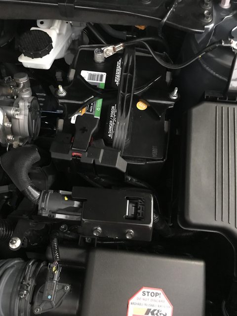

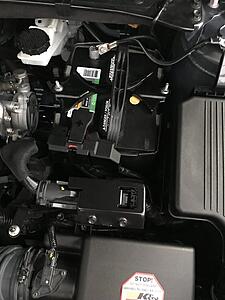

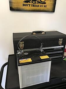

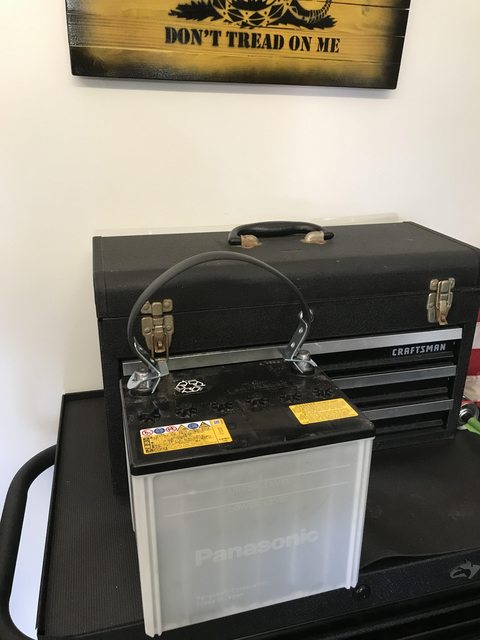

george m44's Avatar
Joined: Oct 2014
Posts: 41
From: SW Florida
Default Replaced battery
Thank you gentlman for replies
Idecided to Replaced Battery Today with a Walmart Everstart Maxx, Group 35, 640 CCA,. $139.84
After removing cables & hold down clamp, I removed insulation sleeve, made it easier to lift battery up and out. I also used a 14" battery strap (Bought on Amazon) to lift battery out. Otherwise, very hard to grasp battery.
Wire brushed posts, applied dielectric grease and reinstalled everything. Vehicle started, no problems, previous settings apear to be saved.
Attachment 8894
Attachment 8895
