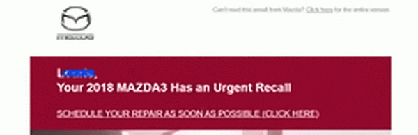

My morning coffee and catch up before off to work and look my buddy is back again LOL
See it is all in the wording... in this example when you say "clearly a very common problem" which at this point there is nothing that documents this. You are simply express you personal opion because it effects you and are blind to real fact and empirical data to support this> Let me put it another way that you can understand.
MAZDA has a SAFETY Recall of the BCM (body control module) that "COULD" effect over 20 thousand Mazda's from approx. 2016-2018. It was apparently a defect in the manufacturing and could cause the wiper to quit working with no pre warning. Thats it! My Mazda was one that received the recall to replace the BCM. Every time I called to set an appointment all 3 dealerships in my area said I would need to leave the Mazda over night and however were sorry they had no loaner vehicle for me. This TSB and Safety notification was first sent to me in January 2019 one month after purchasing my 2018 Mazda. So to recap that meant that by Mazda production information on the effected models 20,000+ were included in the RECAL SAFTY notice. Yet here we are November 10 2023 and Mazda has yet to change my BCM and the wipers have long surpassed the infant mortality rate of electronics that could fail no fail period. That is not only documented number of possible failures but also MAZDA in a way like you may not have lived up to the best service to me. The closet Mazda dealership is 35 minutes away from me one way. Point..... I am not beetching about the service, nor that I was not offered a loaner.
As for why your diesel is experiencing the engine issue and you asking all I can say is you can ask all you want but from my understanding MAZDA has not established the reason yet so until they do and if ever they do sure you can ask but don't expect an answer that is empirical and directly from MAZDA.
Another example is the TSB for oil problem and the service is to replace the valve stem seals. There are numerous effect engine and many on Mazda owners on a few Mazda forums, yet MAZDA has not given documentation and epical information that states the exact cause only a TSB that seems to resolve the issue by replacing the valve stem seals with a new part number. BTW the new part numbers MAZDA has not given what the difference is between them and the old part number. Now in this case there are more effected engine then your very rough estimate of diesel engine head/engine gasket concerns? The procedure btw depending on the dealership can take 1-3 days based on the dealerships service departments scheduling. And again, not all the MAZDA owners that had to leave their MAZDA were provided a loaner.
The last part sharing experience is not what you are doing... really? Anyone reading it can clearly understand your frustration with your MAZDA but in the end, MAZDA is taking care of it. Its just not how you want them to do it and that would be your expressing feeling and opinions but not how it works ITRW (In The Real World) And to point out one more time MAZDA is serving your engine at no charge and HONORING the WARRANTY.
