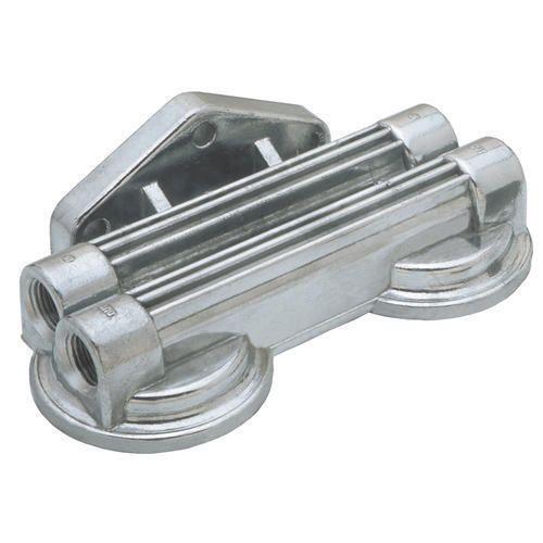

As far a oversize filters, common sense applies. The more area the better oil flow. The flow through a larger filter would usually be 'slower' and therefore
more material would or could be trapped. An oversize filter would also be less likely to be in by-pass, or in by-pass for less time when oil is a freezing
temperatures. (snow belt, Canada).

Are you sure you can? Don't see how. It's basic science, the greater the area the more oil can pass through. At a given flow rate, the larger the area
the slower the oil will be moving. that means that some marginal particles that might pass will possibly be captured.
Both Mazda filters use the same gauge canisters so pressure isn't an issue under normal circumstances.
FYI toilet paper filters are still out there and available. Reportedly they work well, but the particular paper roll is the critical factor with that system.
Depending on the particular design dual filter system could have oil flow through one filter first or through one more than the other, so of course, one
could warm before the other. So?

Dennis better go and look at the common dual filter mounts first available through Cal Customs and later Transdapt than Morrroso Mr Gaskit and few other over the years. .. LOL Your explanation of how they flow oil is not correct and fluid dynamic does not work that way either. Try again, I suggest go to a website and learn Fluid Dynamic's than come back with a more educated explanation or at least stop posting incorrect information? I have had to explain to dozens or more customers over the years that concluded a defective dual oil filter mount because of the same reason you keep posting thinking it was defective.

I took the liberty found a picture to use. If pressed I could go find a couple of mine but I think this will do. Please let me know if you really want a picture of mine. LOL
the flow is not in and out individual filter so when the fluid fills both filters only one filter will flow the normal and full flow rate amount until it becomes full, and the filter by-pass kicks in then the second filter will get flow

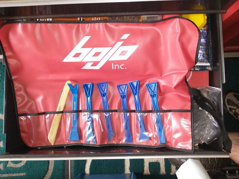

The RIGHT or passenger side of the MAZDA.
Never assume the size of the drain plug and always confirm before removing it.
The proper tool for removing plastic panel fastener is a plastic tool NOT a screwdriver which can easily damage the fastener beyond reusing it!!!
Why go to armature You Tube videos when we have a member that is ASE Certified oh and Master Technicianas well lol and has posted the oil service procedure having to do with a Skyactiv engine many times on a single thread?
Mazda3 Things I like to do - Page 19 - Mazda Forum - Mazda Enthusiast Forums
This is an example of those plastic fasteners. I was not going to raise my MAZDA to use the exact oil filter and drain plug access for these pictures I took this morning. LOL But you can understand my response last!
I also noticed as you can see in the picture that had been the very first time that fastener had been removed from my MAZDA sine manufactured from MAZDA. But then I would have no servicing reason to remove the splash guard .
And just for the record this is my personal supplies in my home garage that often need replacing mostly because of wear or deteriorating on various vehicles I own.
Most of us DIY types don't have access or the funds for an deluxe extra special, fancy tool to remove two plastic plugs once or twice
a year. An alternate would be to keep a couple of extra plugs in the tool box JIC.
Not expensive on Amazon.
