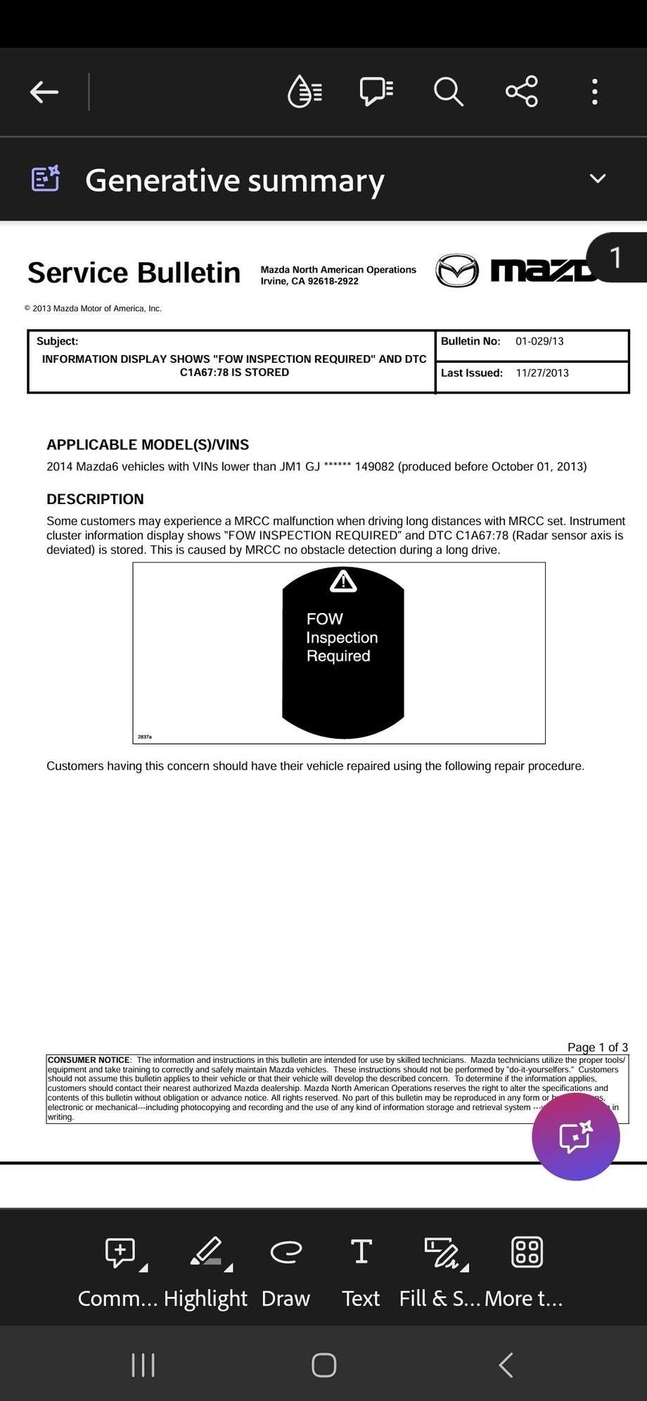

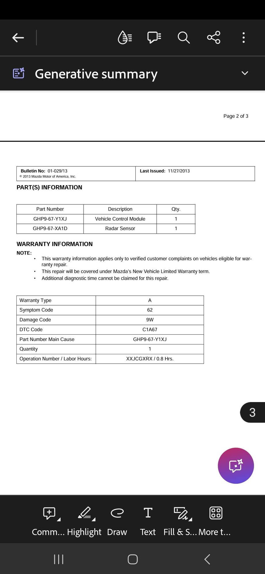

Try to disconnect battery overnight to drain diode, t
hen reconnect in the morning. See if that resets the camara.
if it still fails, cgeck fuse, wiring connections etc. Remove Camara and clean and reinstall. wires and pull on connectors in case lose.
what can you lose, if they are asking 2k.
worst case buy $600 scanner tool that reads codes and recalibrate etc. And install yourself.
Here is the fix just googled it. 3 screen shots attached. Buy the workshop manual if required to recalibrate. See photos
note, Labour cost is 0.8 hours.
if you don't try to fix this yourself first with the help of dealer Workshop manual, then you should be shot twice! 🤣🤣. Don't give up.
