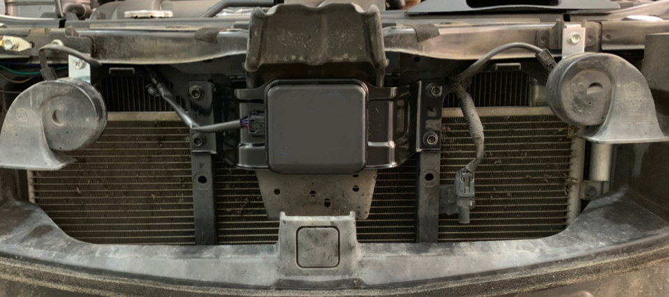

I recently ran over a big hunk of truck tire retread in my 2017 CX-5 Grand Touring. It took a chunk out of the bottom of the bumper cover. When I got a repair estimate, I was told the bumper cover basically covers the whole front of the car and would have to be replaced. The estimator also said this would necessitate removing the grill. He said if the car has adaptive cruise control, it may not work (cruise control would work, just not the speed/following distance function). If that's the case, the car would have to be reprogrammed at a cost of $400-$500. Is this true or is the shop looking to pad the repair?

If there is only damaged to the bottom of the bumper, and no structural tweaks to the front support then nothing will need aligning or re-programming. as the Radar is mounted to the support panel/frame and not the grill or bumper.

Totally BS, front distance radar is mounted far away from bottom bumper and about 8" to 10" behind front grill and Mazda emblem.

I ended up submitting a claim to my insurance company. I compared the insurance estimate to the estimate I got initially and they were very close. There was no sensor estimate needed, though the insurance estimator said he had seen it be needed in more serious accidents.
