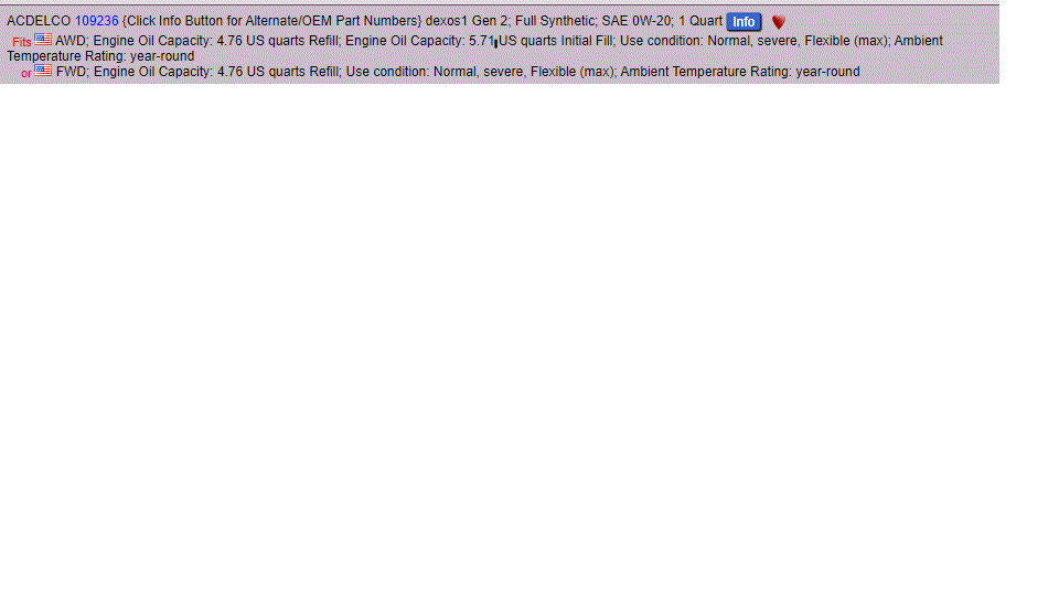

Dealing with a 2016 CX5 oil change today. My granddaughter bought this used CX5 last summer. It took 5 quarts and 8 ounces to refill after an oil change. But before I filled above the 4.8 quarts recommended for this 2.5 L engine, I verified the dipstick was the correct one with the dealer. 4.8 quarts had brought the oil level to the add mark on the dipstick and I wanted to understand why it was not full after adding the recommended 4.8 quarts. I happened to check the Rockauto.com parts page for oil for the CX5 and on this page it is noted that on a NEW CX5 it takes 5.7 quarts to fill but only 4.8 quarts for an oil change. So, it appears that 0.9 of a quart of old oil is usually left in the oil pan when changing. Looking at a photo of the oil pan on several different web pages, it appears there could be low areas in the pan that are below the drain plug. Also, the bottom of the drain plug is not flush with the bottom of the pan. I think it could be possible that if the front of the car is raised fairly high to access the bottom of the engine for the oil change, it could allow more of the used oil to drain from the oil pan than would drain if the car were level on a lift or level over an oil change pit. In that case it will take more oil to refill. At least that is what I am hoping since it took 5 quarts and 8 ounces to reach the full mark on this dipstick. Has anyone else noticed this?

Yep, 4.8 is in the book. Grim_reaper, you don't feel raising the front of the car can drain more of the original 5.7 quarts (that Rockauto.com shows is needed in an original fill of a new car) than will drain when the car is flat on the ground or on a lift? I am looking for a good image of the oil pan showing the lower spots or the height of the drain plug above the bottom of the pan? Is there information out there stating that 0.9 quart of oil is left in the pan after draining for an oil change?
From Rockauto showing oil fill info. 5.7 quarts for a new CX5, 2.5L and 4.8 quarts for an oil change.
