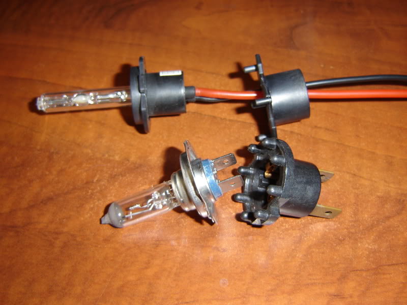

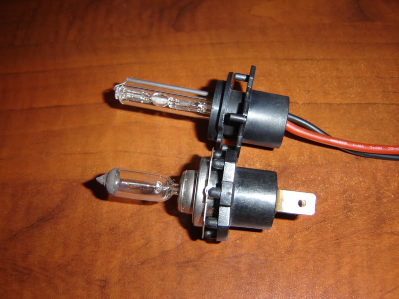

I don't know how to put pics up. But i took two pics of the HID bulb. http://i143.photobucket.com/albums/r...207082110a.jpg
http://i143.photobucket.com/albums/r...0207082110.jpg
Old Feb 7, 2008 | 10:25 PM
2.0Mazda08's Avatar
Joined: Feb 2008
Posts: 440
Default RE: HID Kit Installation
Is that the piece we are talking about here ....can't i take it off the existing bulb and put it on the HID Kit bulbs.?
sorry about the repeated uploads... i just now figured out how to post pictures.
http://i179.photobucket.com/albums/w...207082110a.jpg

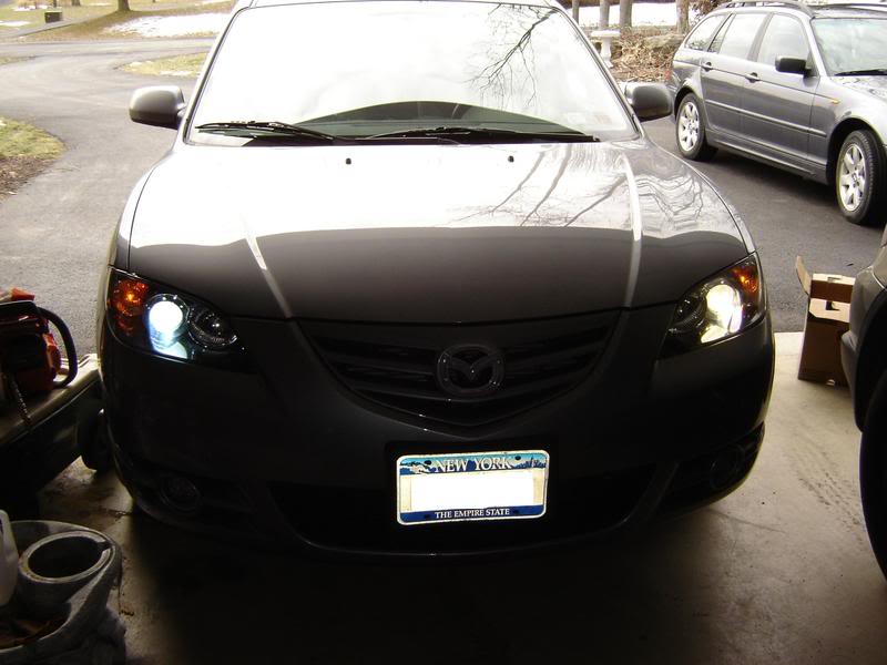

That piece comes attached to the HID bulb. The only way to take it off is if you break it. That piece is only there to fill in the space that the halogen adapter takes up. The halogen adapter has a socket for the H7 halogen bulb to fit in, and prongs to plug into the car. Here are some more pics to clarify a little more. Pic oneis the halogen bulb and its adapter detached. The HID bulb is next to it with its filler.
Pic two is the same thing but with the halogen adapter attached next to the HID bulb.

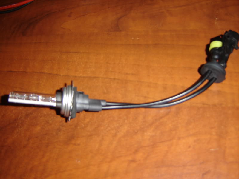

Pic three is a picture of my 8000k bulb. This was the first bulb i got when i didn't know much about these kits. I told the guy that i wantedthe same color output as OEM HID's and he told me the 8k's would do. He screwed me because these were more expensive than the 5k's. I got them from xenonpros.com. I highly recommend NOT using them.I did enjoy the 8k'sbecause they made the car look hot, but they weren't practical at night. Let me get to the point now. This bulb did not come with the filler. There were these round foamy things that came with the bulb's packaging and fit around the bulb. I put those on, along with a few cotton pads (fire hazard I'm sure) to fill in the space. The bulb fit in just fine with the added cushioning. I think this is your problem. If you get the bulb with no filler, find things to fill the space that won't behazardous.

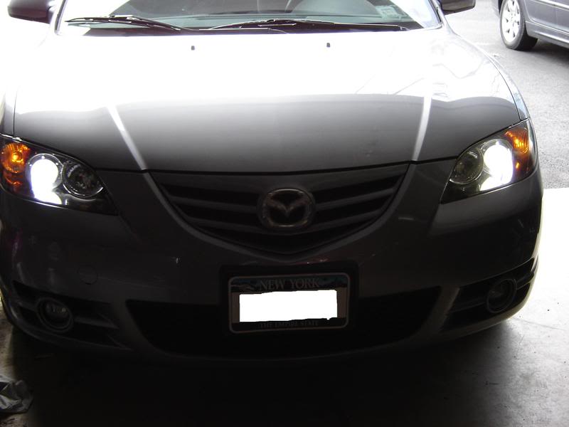

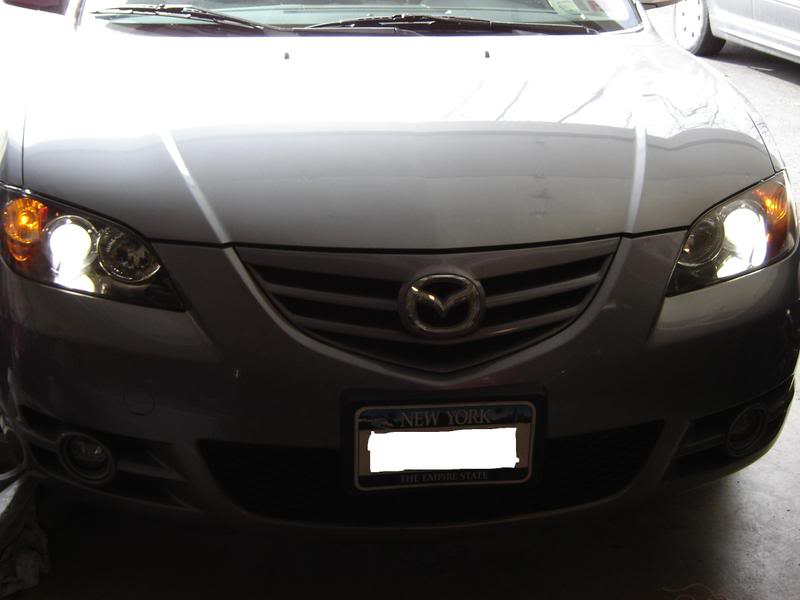

The rest of the pics are my car with 8,6 and 5k lights and what their color outputs look like. Just to show you what the car looks like with HID's.
This setis what the car looks like with the lights.I only changed the passenger side lights, so the driver side is all 5k. I have the pics starting with 5k then 6k then 8k.
5k Name:  DSC01703.jpg
6kName:  DSC01711.jpg
8k Name:  DSC01705.jpg

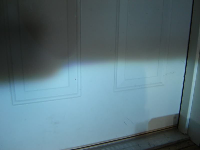

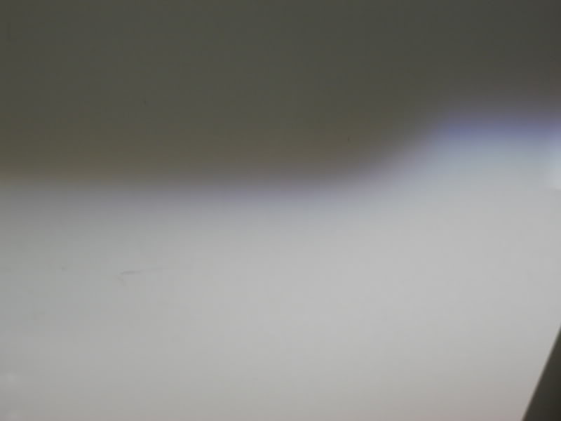

These sets of pics are their output. starting with 5 then 6 then 8k.
5k Name:  DSC01716.jpg
6kName:  DSC01710.jpg
8k Name:  DSC01708.jpg
Hope I've helped.

So I suppose it's possible to make your own adapter for the H7 HID bulb, but the stock adapterclearly will not work as it is.
I once read a post on another forum that was debating this question and theysaid Mazda charges $12 ea. for them.
Why do they (Mazda) use these things in the first place? And why the hell can't they make a bulb clip that works!! I know the Proto guys have the same damn problem as we do w/these stupid things. Frustrating!! [:@]
