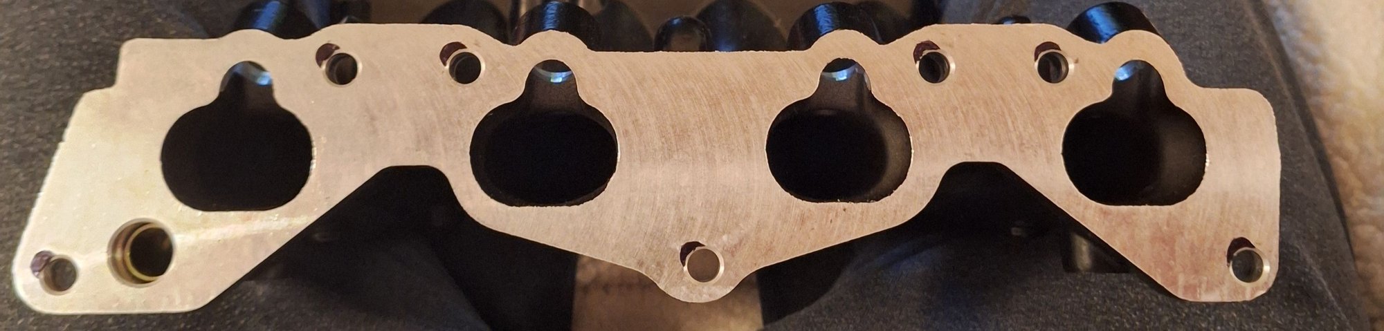

Getting around (and bored enough) to playing with that cheap intake. Check out this misalignment.
😬 Jeez-man! This thing might be unusable...
I checked the gasket, it is 100% dead on, to the original casting. Bummer...

Posts: 10,594
I know you know….. If the intake is smaller than the head port intake side you can blend port to eliminate an obvious head to intake issue . To many hot rudders exaggerate match porting and those that do most of the time can’t be measured on a DYNO with what we would call normal activities in a real world use. Now drag racing or WOT frequently on a road track then the slight improvements may give you an edge on a straight section of track.

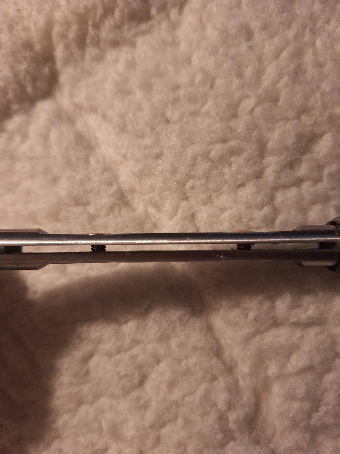

Throttle shaft is cleaned up. Looks much better. Drilled to sink the screws and cut to length. Good enough for a street car.

The cutting and grinding is fine by me. But the 9 o'clock to 12 o'clock positions of every port might need filling. Which... I'm not sure it is worth the work.
After looking and thinking with a covid brain... looks like moving the mounting holes would fix it. Slot and fill the mounting holes for realignment.

Here I have marked where the mounting holes should have been. Black sharpie. Soooo... yes, I will fill these holes with JB Weld and re-drill them in the correct spot. That will correct the misalignment and hopefully not cause too much interference with the top of the block. Which I already worry about because of the heavy head milling.
I will most likely be belt sanding the bottom of the flange.
