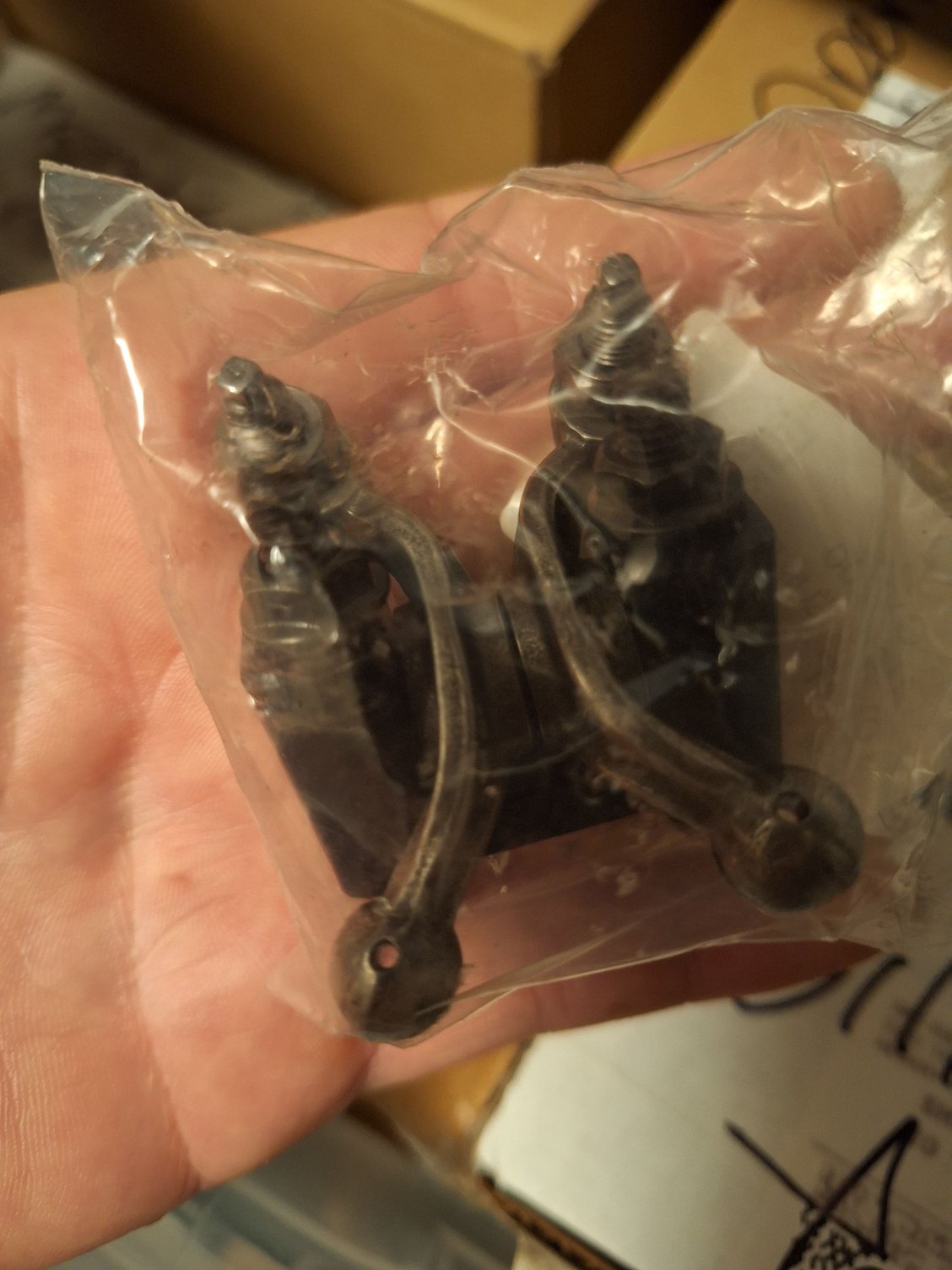

Not as expensive as it was...
I have the non-specifics, check it out.

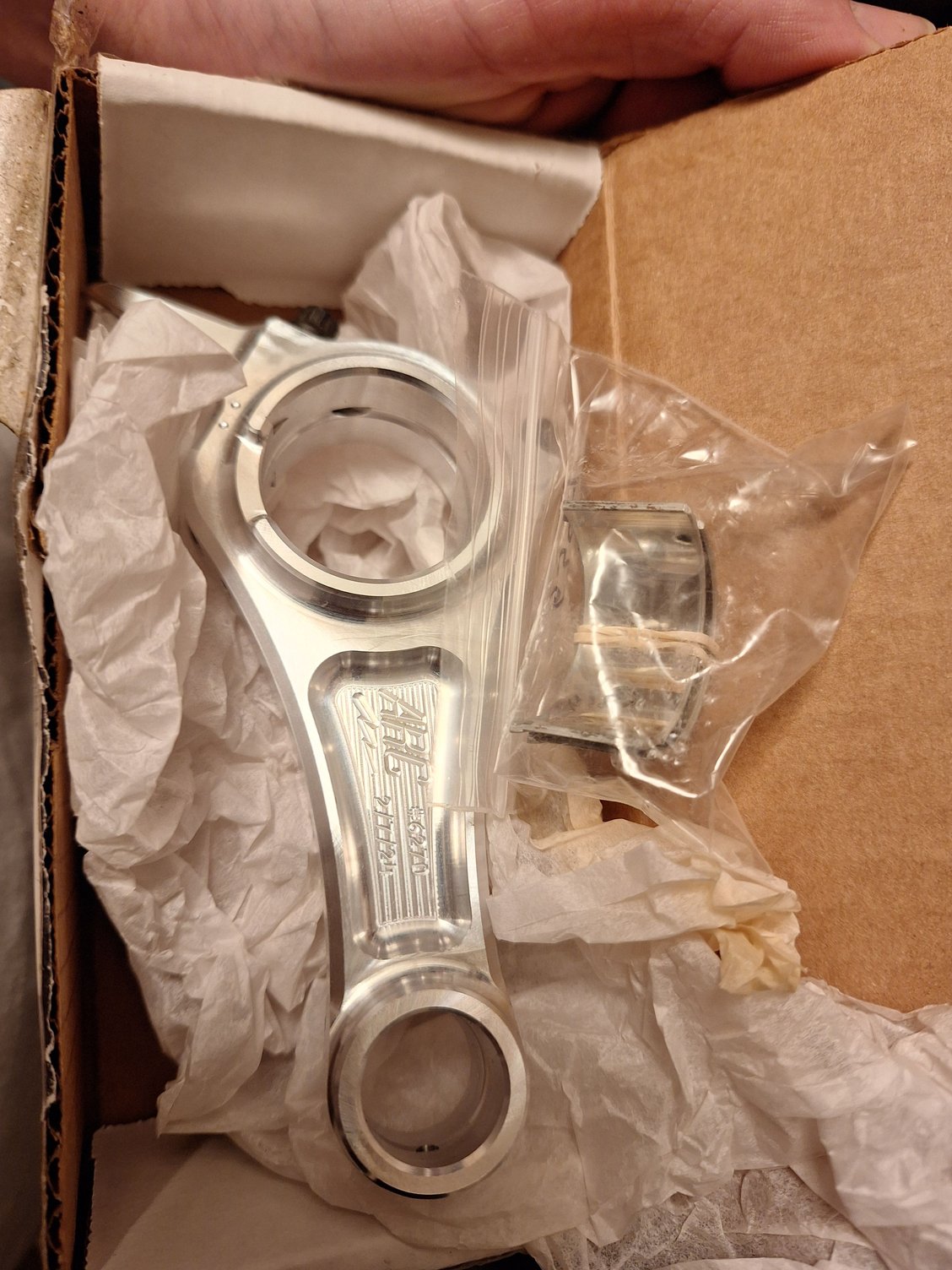

ARC rod, with bearing insert.
Stainless valves +2mm both, 26# spirngs.
Torque cam
Torque cam
Not roller, but durable. Looking for torque not rpm.
24mm PWK flat slide
24mm PWK flat slide
14cc head, large valve. This one will be fun, tons of fill and port work possibilities.

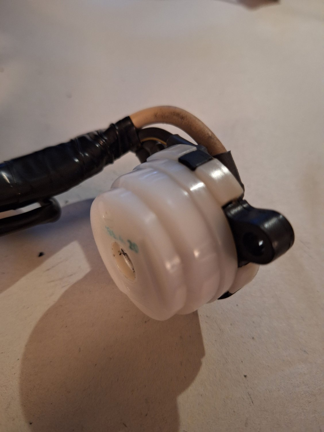

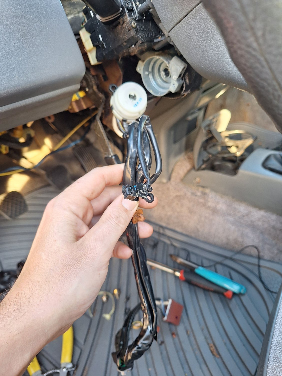

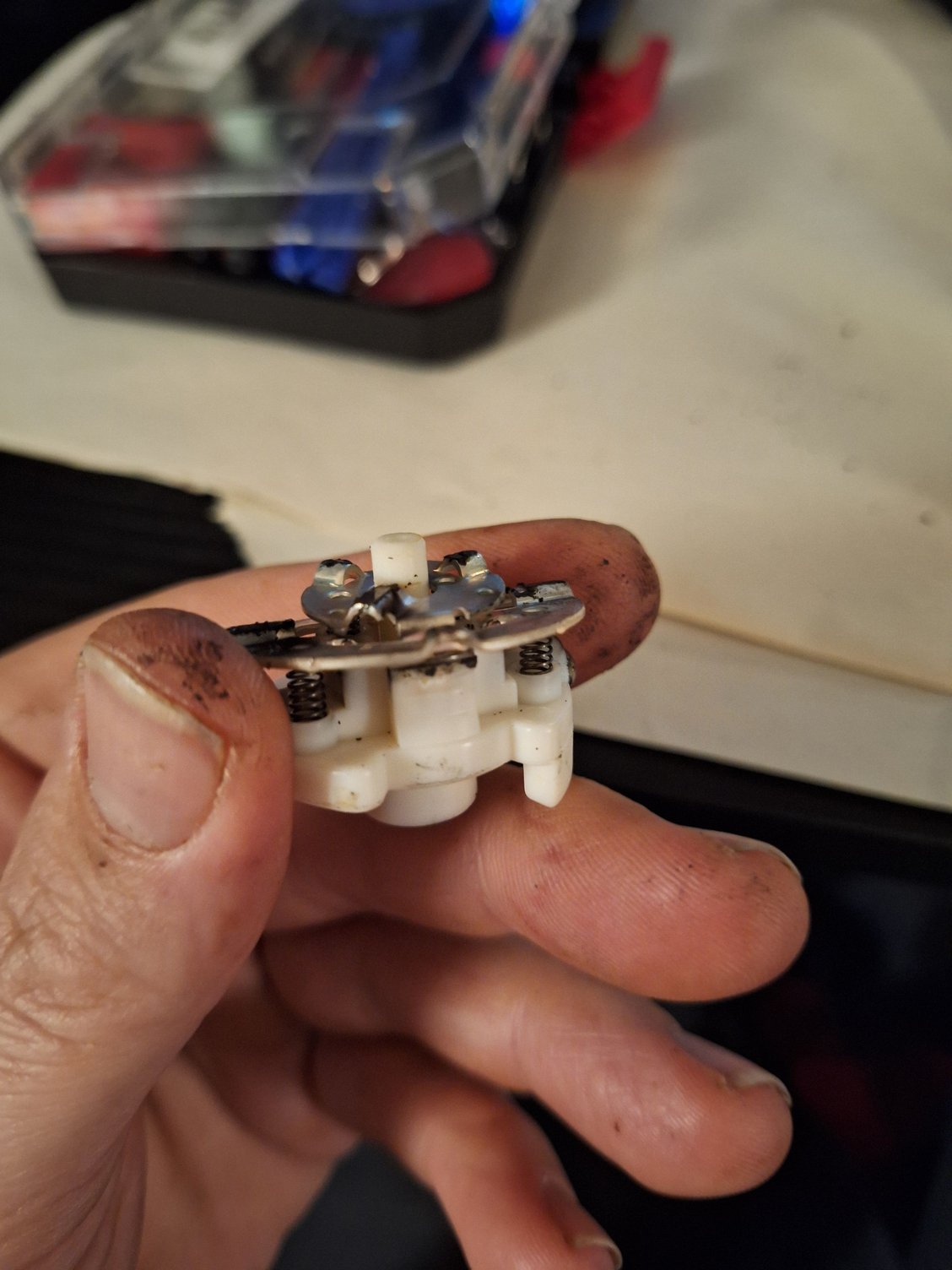

Original switch had a plastic clip-in strap broken. It was for a 5 speed. Went to the white automatic car, and pulled the switch.
Let's see what it takes to convert it to a manual... 😁

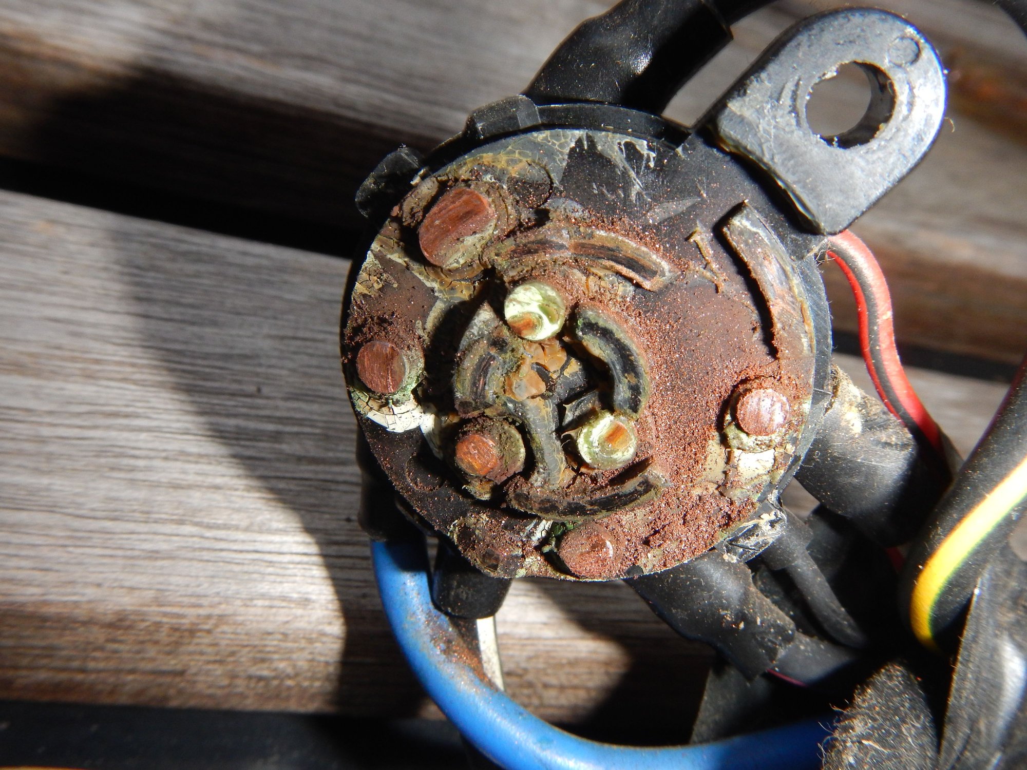

Some of the Mazda B-trucks get nasty in their ignition switches......

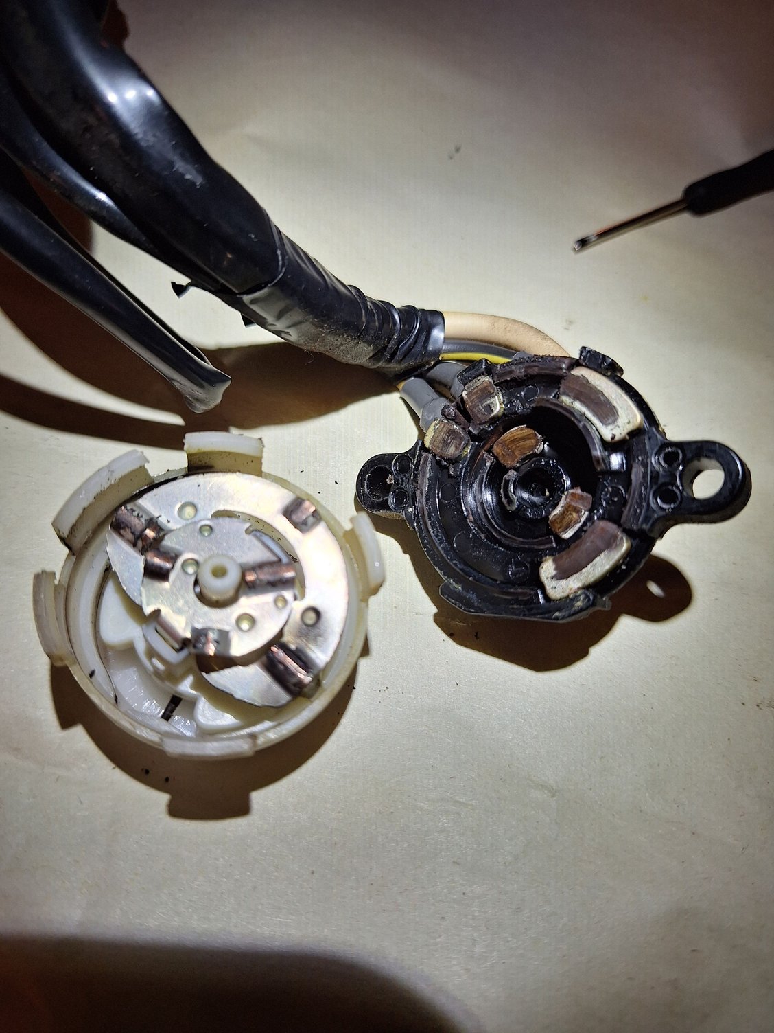

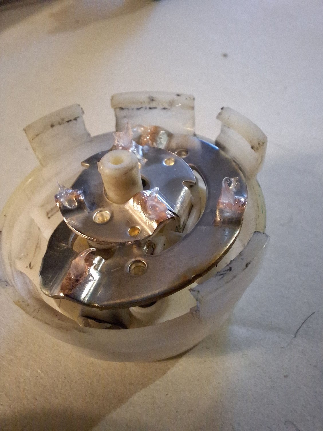

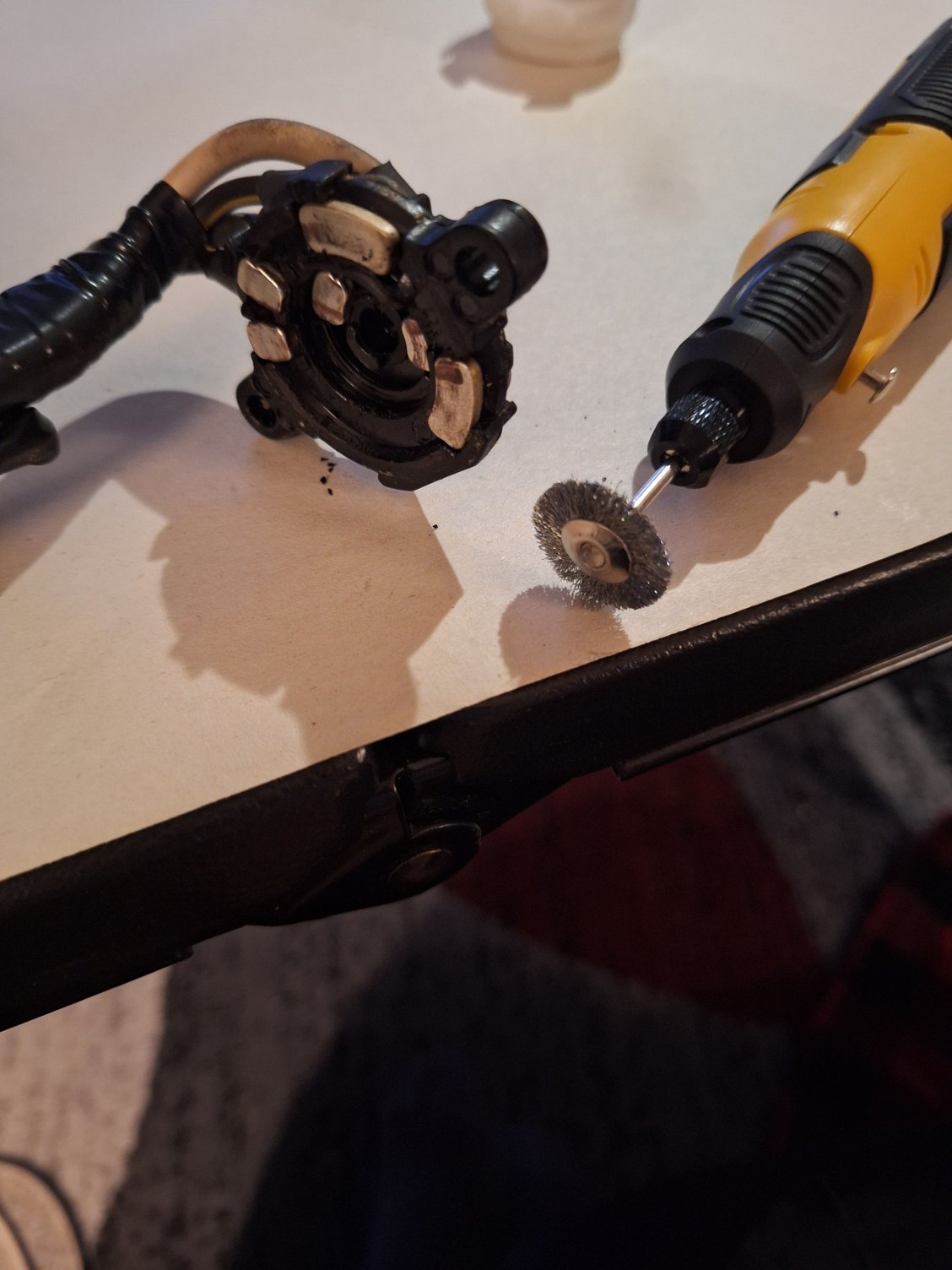

Little dab of dielectric grease.
Little dab...
Little dab...
Cleaned it with q-tips and acetone. Actually finger nail polish remover... because it is cheaper by the OZ.
