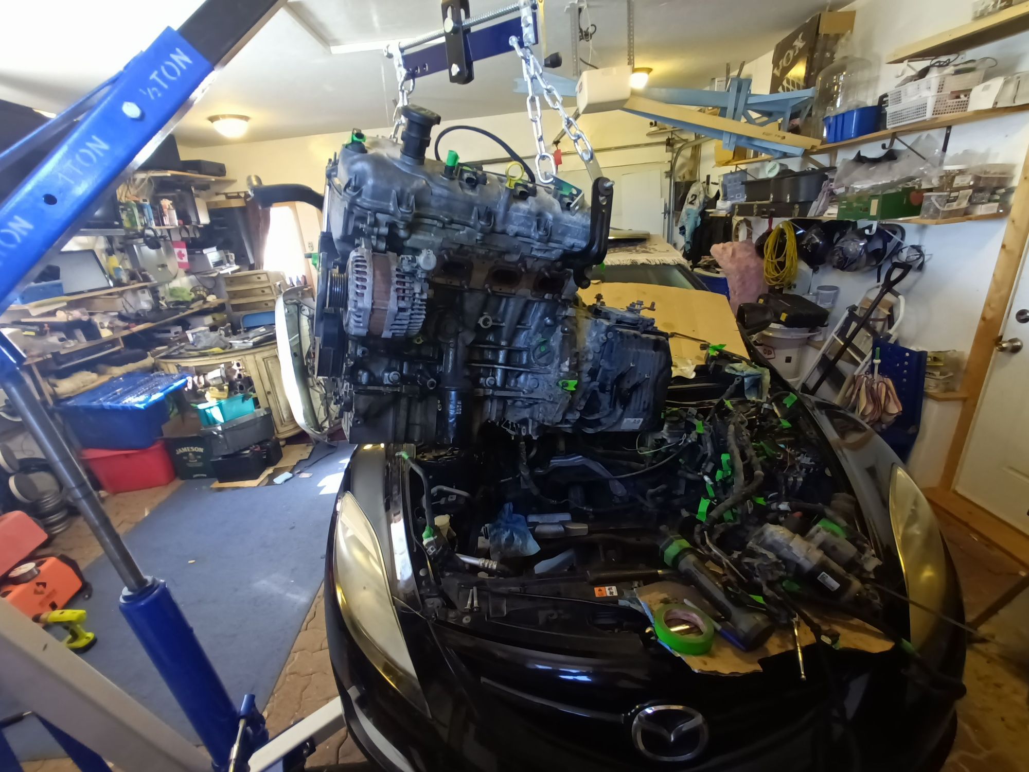

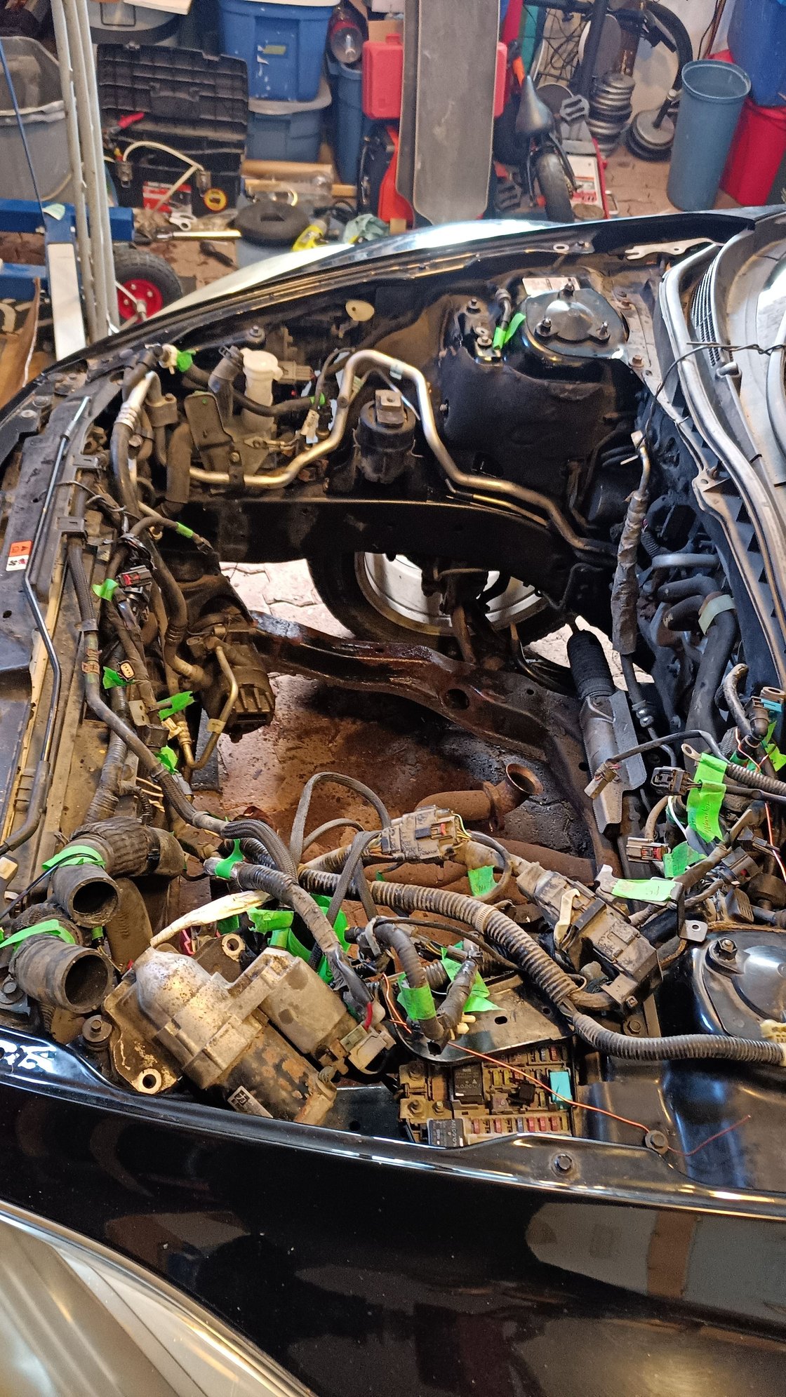

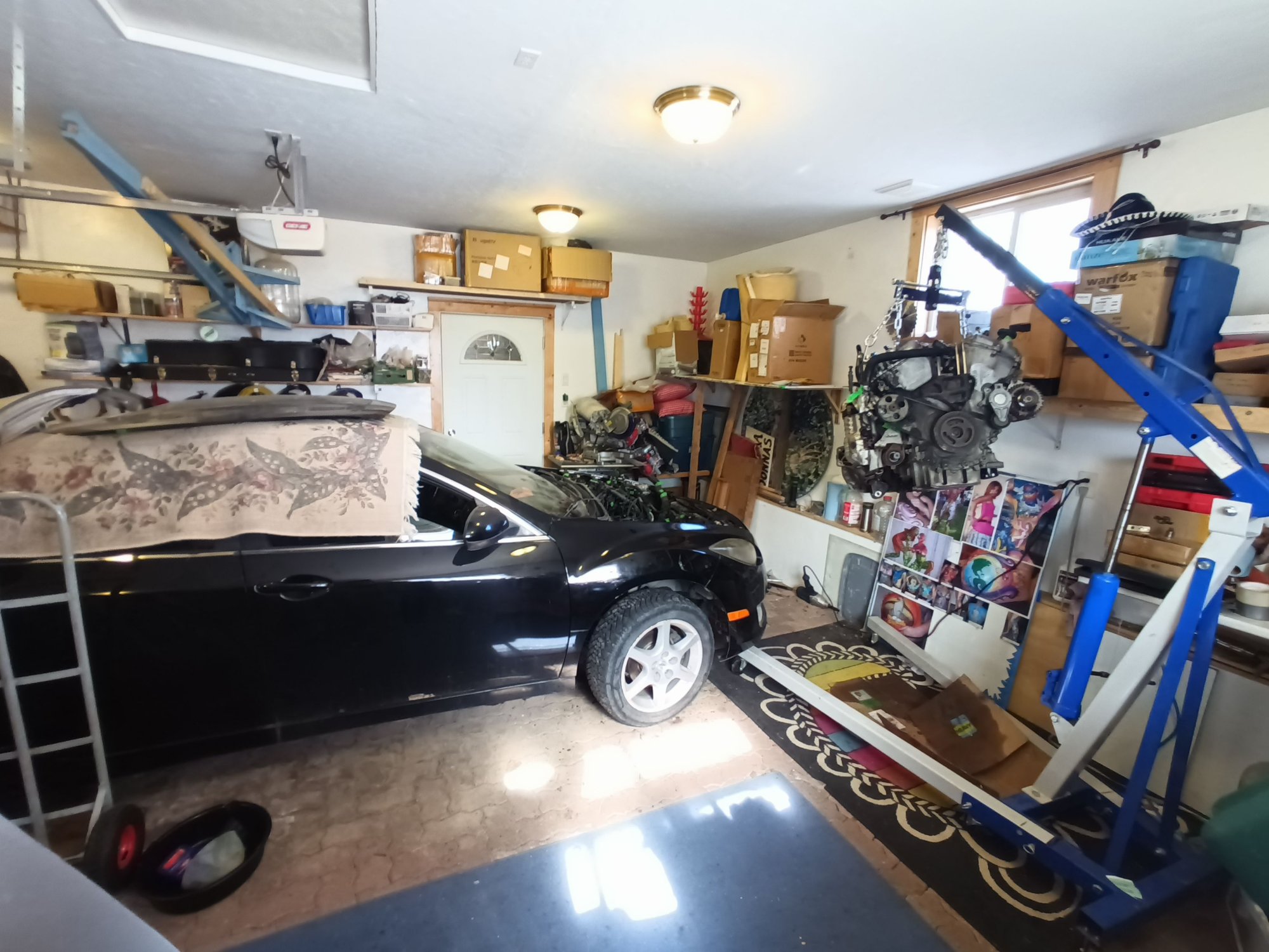

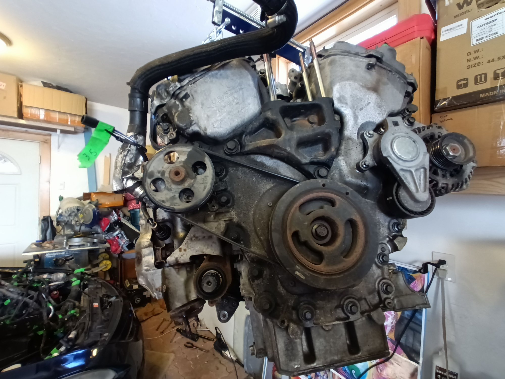

Ok, I was able to extract the engine through the top. I've labeled 40 connectors and brackets point so I'm going to be able to put it back into the car. I didn't need to take the front or radiator out of the vehicle, just straight up. In a few days I'll replace the water pump when I have the time.
