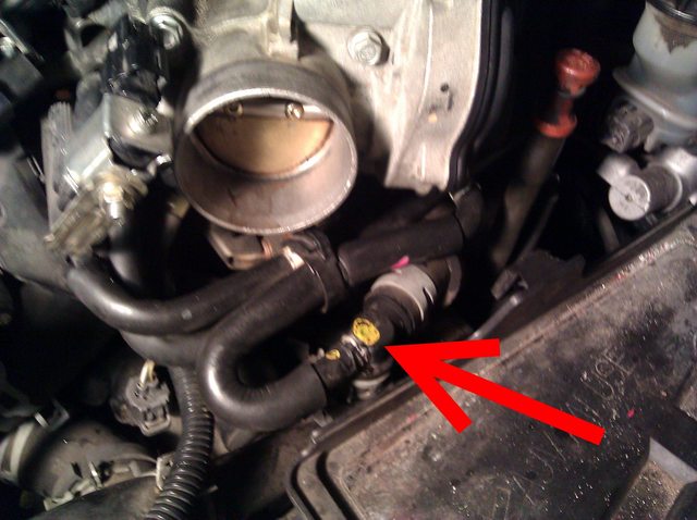

A little plastic part fell off of it and now it is leaking coolant.
Here is a wide shot of it. It is the part with the big yellow mark:

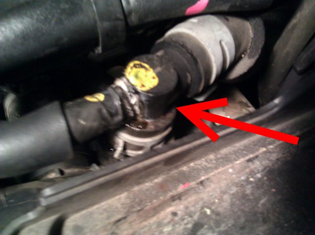

This is a closer shot:

That is the Dreaded Plastic Coolant "T" under the throttle body. You have to be careful when doing stuff to the throttle body/intake plenum as this happens as a result of too much moving of the throttle body usually.
