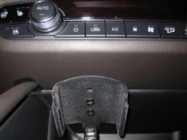

One of my objectives was to keep as much storage space as possible (front cubby, cup holders, center console, etc.). I found that fastening the ProClip holder directly to the roof of the front cubby would allow this. This also eliminates the need for both a ProClip mount and the swivel base that comes with the holder. To secure the holder, I drilled out two of the ProClip’s existing holes to accept large, short flat head screws. Here’s how it turned out:
ProClip Holder Mounted to Top of Cubby

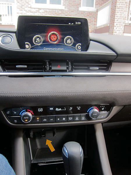

Path for Cable Run Under Console to USB Port
USB Connection
Empty Phone Dock - MZD Display
Phone Docked - Android Auto Display (Waze Navigation)
