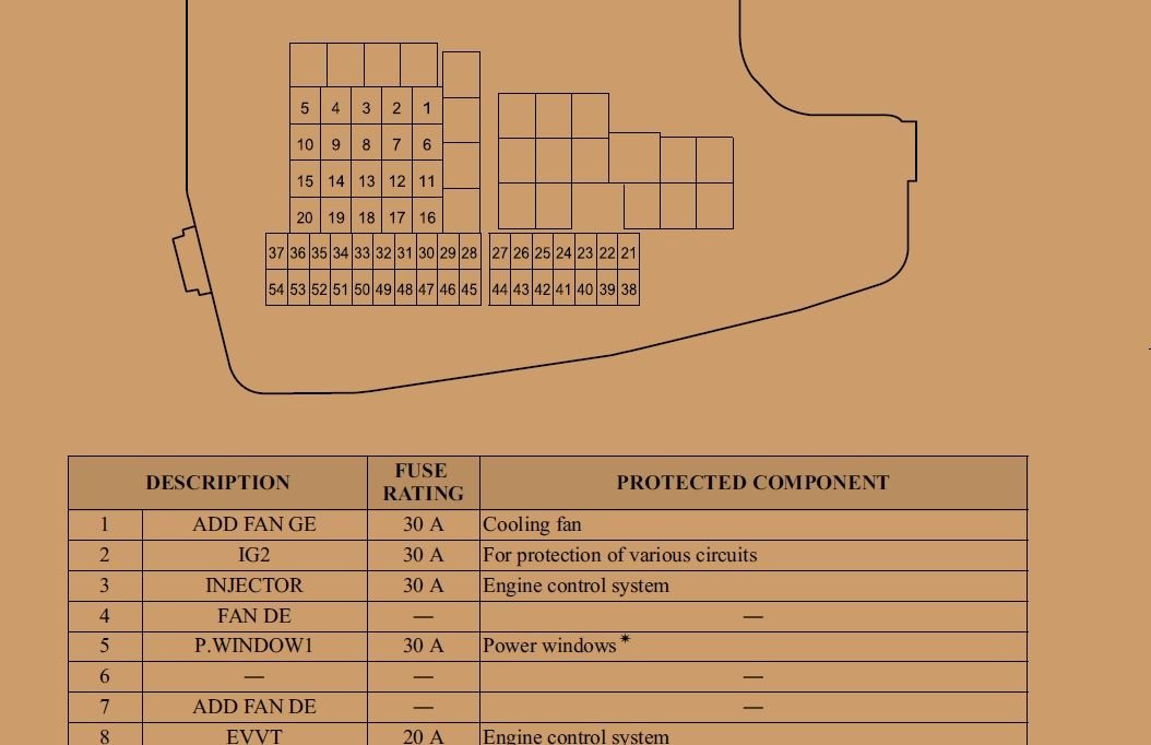

I have Mazda 6 GJ Touring - 2014 - 2.5 Petrol, my rear power windows aint work at all. Front driver and passanger working fine.
Anyone could please give me some direction where should I start with fix this issue?
My Mazda 6 is USA version.
I've checked fuse box and I have empty slot here and only see one pin there? Is there should be fuse or not? cos I found out in manual book that some models come without this fuse.
On the picture fuse 30A place nr 2 - my slot is empty but I've seen some fuse boxes on google and they have it placed in.
Im appreciate for any help.

Thank for your reply. That would be to obvious. Rear PW aint work even from driver main switch panel. No power cannot hear any click or something.
Tomorrow I will chech fuse nr 5 in engine box but it seems to be that this slot is supposed to be empty as come from factory.
It could be that all PW are supported only on one fuse?
Can anybody confirm that have this fuse nr 5 in the car?
