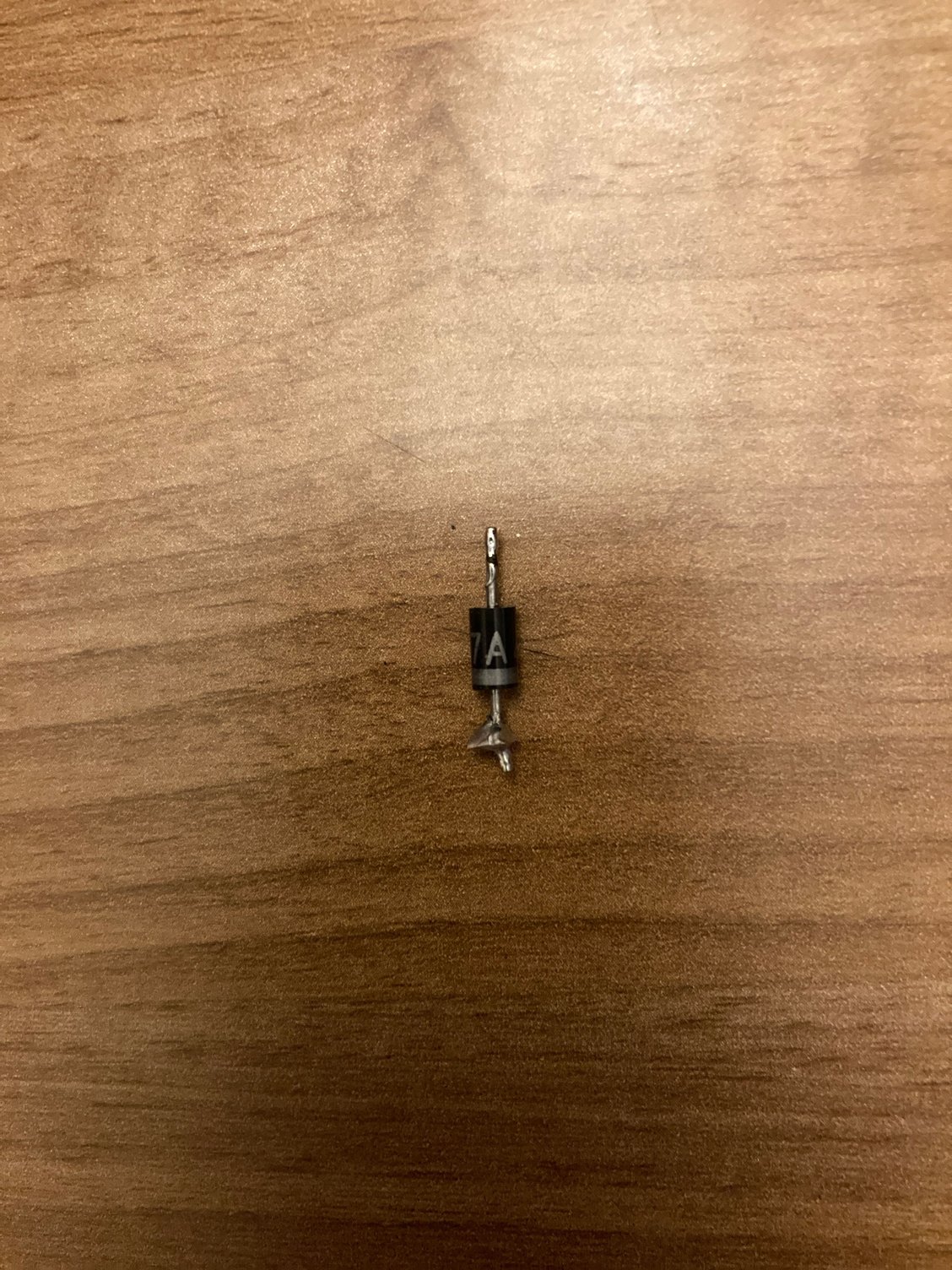

Mazda 6 2005
This little diode could be the problem to most of your central locking issues . I carefully pried the module apart being careful of the blue motor cog inside and found one of the two diodes had blown hence hearing only part movement inside the motor housing . Now changed the central locking works perfectly. Oh and of eBay our trusted friend i was able to purchase 50 yes 50 for £1.59 with postage . Item number 1N4007.

You're describing the problem I'm having. Where exactly is the diode located?
