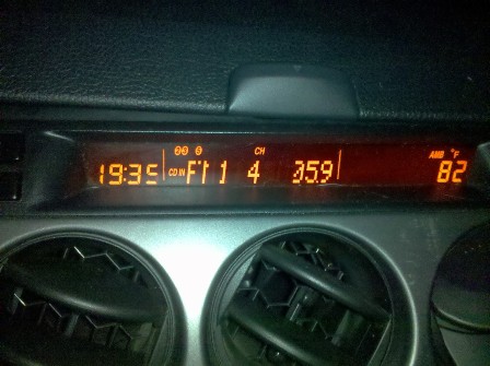

The wife and I always thought Mazdas were great cars, and for the first 71k miles it seemed that way. The craftsmanship inside and out seemed flawless. With less than 72k miles on our Mazda the main bearing spun on the timing chain side. I have spoken to Mazda service reps several times and voiced my concerns over a major issue such as this with less than 72k miles on the car. I have been told it's an isolated issue. For them maybe-for a U.S Marine I am not happy about having to pay for an engine replacement. How can it be the remanufactured engine I just had to pay thousands to have put it has a warranty of 100k, but the original engine only goes to 50k? Seems to me that Mazda doesn't put much faith in their product. On top of that the clock/radio display has several lights out, so you can't even read what channel it's on, etc.

I have the Mazda 6 2005, V6. Also just replaced the engine - was luck to get a used one with 19,000 miles on it for 2100.00 Total of 4,000.00 to fix it.....I have a great mechanic.....prior to fixing it I was putting 2-3 quarts of oil a WEEK in it!! Yes - a WEEK! !
But now.....I want to replace the Radio display, as mine looks just like yours in the picture you posted. Where can we get a replacement for it????
But now.....I want to replace the Radio display, as mine looks just like yours in the picture you posted. Where can we get a replacement for it????Good Morning all,
