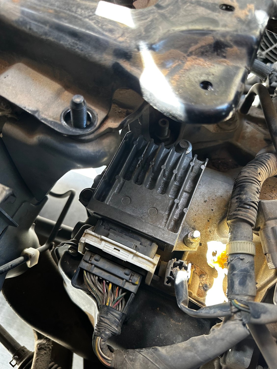

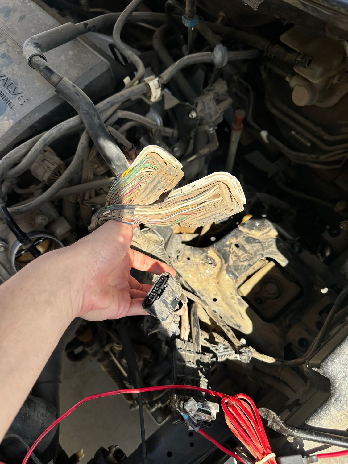

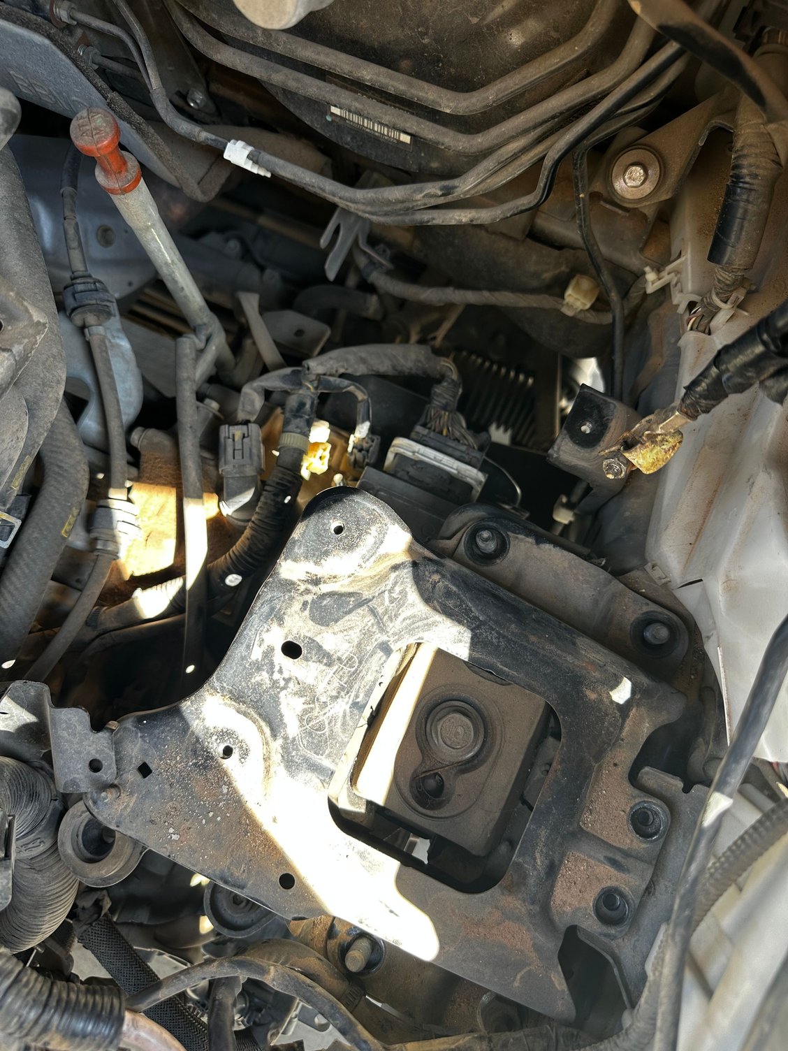

Not sure if you ever got this fixed but for those wondering. On 2012 at least the cm is located under the battery tray and driver side engine/trans mount or top of the transmission. You have to remove the air box assembly, battery and battery tray/ecm. Everything uses a 10mm socket and there's plenty of room. There are three bolts for the cm two of them can be a little tricky to access because of the engine mount. I'll try to include some pictures.

All electrical connections (Ecm and MAF) excluding the tcm connector.
Engine mount overview with tcm underneath.
Tcm overview from firewall pov.
