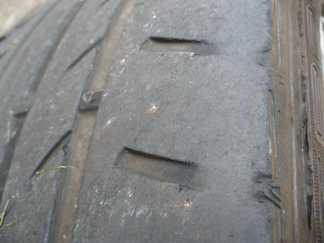

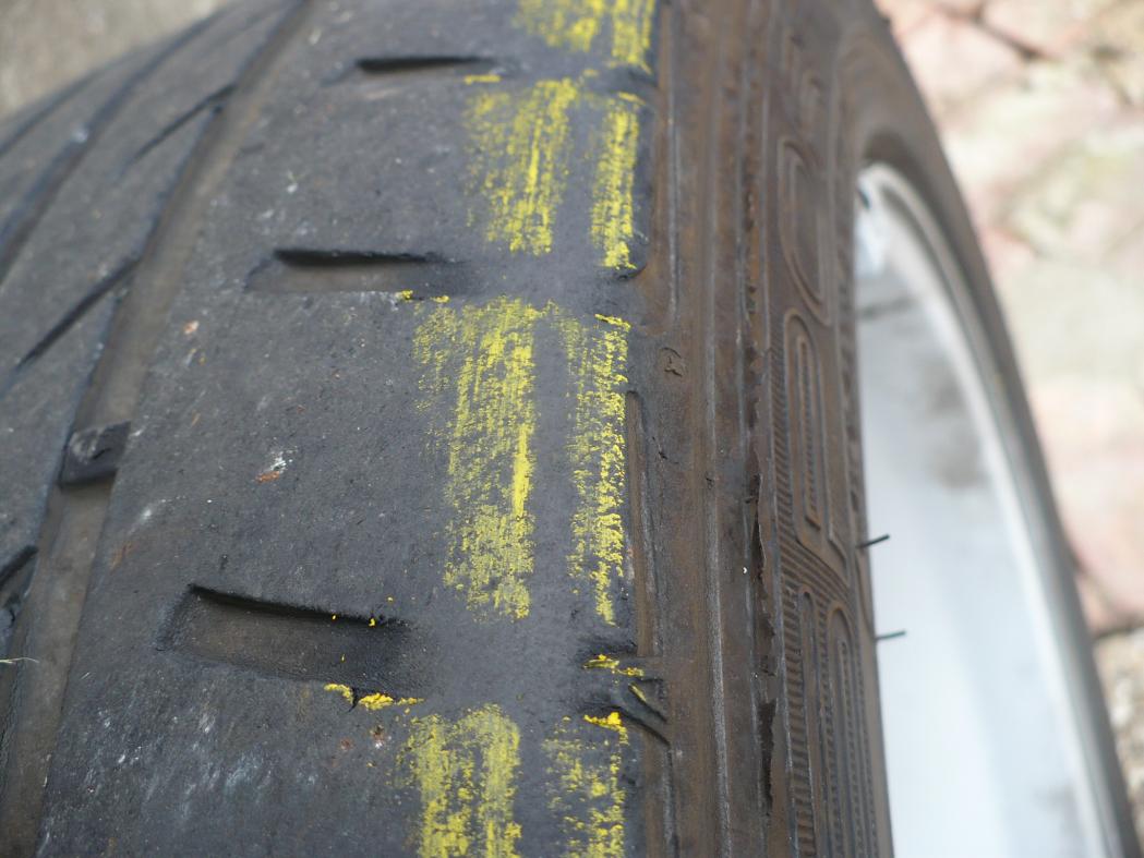

That's good as that is part of the Terms and Conditions of your hire purchase agreement. Do let us know in due course how you Continental tyres fair on the inner edge in 6 to 10000 miles (the grip in wet and dry and on painted lines). I am in a similar situation but I am still pursuing the fault as a matter of course as a health and safety issue with this particular car that can cause us to crash in the future. See the picture of my replaced first replaced tyres. I want to go back to Dunlop 2050, as the Dunlop Sport Maxx are abysmal in performance (no grip in dry even, in this country (UK)). See on the second picture that there is the uncrayoned band, that I must assume, when fitted to car and loaded, must 'stick out' further than the rest of the tyre to result in this extra worn band when removed from the Mazda 5. I would hope to have the replacement authorised very shortly. I emailed them with pictures on Thursday. I will not embarrass Mazda by turning up and having them lie about it not being worn or indeed dangerous, giving their unsupported claims that it is either over inflated or under inflated, excessive speed in cornering or the state of our roads. Neither of which has evidence or symptons to indicate any of their 'claims'. The symptoms I see and feel are that this car has an incorrect camber. Because all they will do is photograph the legal tread pattern and measure tread depth.

If it was under inflation the tyres would be worn on both outer edges of each tyre, and more so on the outer, for the obvious reasons. I just came back from Kwik fit and they said 2050 are not available. I don't want Dunlop Sport Maxx. Any suggestions? I'm looking up information now as to what to get. Bear in mind if I pick tyre not to Mazda's liking they will blame future wear on my choice of tyre.

The official answer as to whether the problem has been solved for the 2008- mazda 5 model with inner edge front tyre wear is NO! Simply because Mazda, as yet, have not recognised that there is a problem with the front wheel geometry for vehicles fitted with 17" wheel. Therefore they will have done nothing to cure it. Other than this worry the car is fine, no, great. So as long as you monitor the front inner edge (see previous picture so you know how far on the edge it is). By the way if you are after a new car, you could use this oppertunity to ask about the problem and get some proof if they claim it's cured. But beware a 'savvy' seller may palm you off with the 2007 facelift and Sport model rear tyre wear issue. They also hide or delay the problem by swapping front wheels with rear wheels (where they wear less) making it seem you get better mileage out of a set of tyres. Does anyone know of an official reason why they change the wheels around at 8000 (or what ever it is)?
