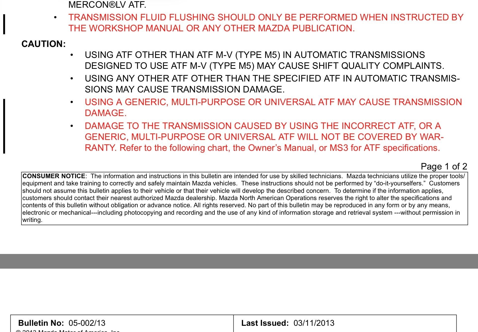

Wow, so much rambling nonsense, using entirely faulty reasoning, logic and wholeheartedly distorting references?
For those with some common sense, here's the Service Bulletin where Mazda says NOT to use Mercon or other fluids:
SB-10097348-2532.pdf

Old Mar 19, 2026 | 11:58 PM
Posts: 10,664
First Thanks for quoting my long response again. When you do that for members only look at the last response on a thread they get to read my valuable and experienced based information again
Ok that TSB you posted .. three words
Yup wrong again…lol
Go read that TSB again…
Highlights of that TSB so a 1st grader can understand…
—————————————————DESCRIPTION
Always be sure to use the correct automatic transmission fluid when replacing ATF. Using the wrong ATF may
cause shift quality complaints or may even damage the transmission.
CAUTION:
• USING ATF OTHER THAN ATF M-V (TYPE M5) IN AUTOMATIC TRANSMISSIONS
DESIGNED TO USE ATF M-V (TYPE M5) MAY CAUSE SHIFT QUALITY COMPLAINTS.
• USING ANY OTHER ATF OTHER THAN THE SPECIFIED ATF IN AUTOMATIC TRANSMIS-
SIONS MAY CAUSE TRANSMISSION DAMAGE.
USING A GENERIC, MULTI-PURPOSE OR UNIVERSAL ATF MAY CAUSE TRANSMISSION
DAMAGE.
DAMAGE TO THE TRANSMISSION CAUSED BY USING THE INCORRECT ATF, OR A
GENERIC, MULTI-PURPOSE OR UNIVERSAL ATF WILL NOT BE COVERED BY WAR-
RANTY. Refer to the following chart, the Owner’s Manual, or MS3 for ATF specifications.
CASTROL meets the specifications recommended by Mazda.

To repeat that TSB only states not to use and ATF that is not specified for the transmission, it DOSE NOT state in any way that it “MUST” or is your word “REQUIRED” be Mazda or Ford ATF.
Shuswap it is owners of vehicles like you that pass bad information on forums that lead others reading you responses thinking you have some actual knowledge of the subject material which clearly Ypur responses indicate you don’t and can even read a document correctly let alone
Having any service training and experience on the servicing of automatic transmission . But in maybe only you think that in your mind?
Now go read that TSB again and find the legal word REQUIRED. And also take notice a lot of the word “may” . Another big word for you in the legal word to Lear how and why it’s used on many documents. Lol

Hard to believe you read the same bulletin and came to such a discombobulated / dumb conclusion, but you are you, eh?
Must be great working with you, ever get a repeat customer? Not often? No surprise, didn't think so.
At no point did I say not to use other fluids, I said this was the latest SB from Mazda explaining why a compliant fluid was required in models that included the Mazda 5 with the 2.5 trans....and suggesting the fluid they sold. I've done several drain/fills with this fluid to great success.
