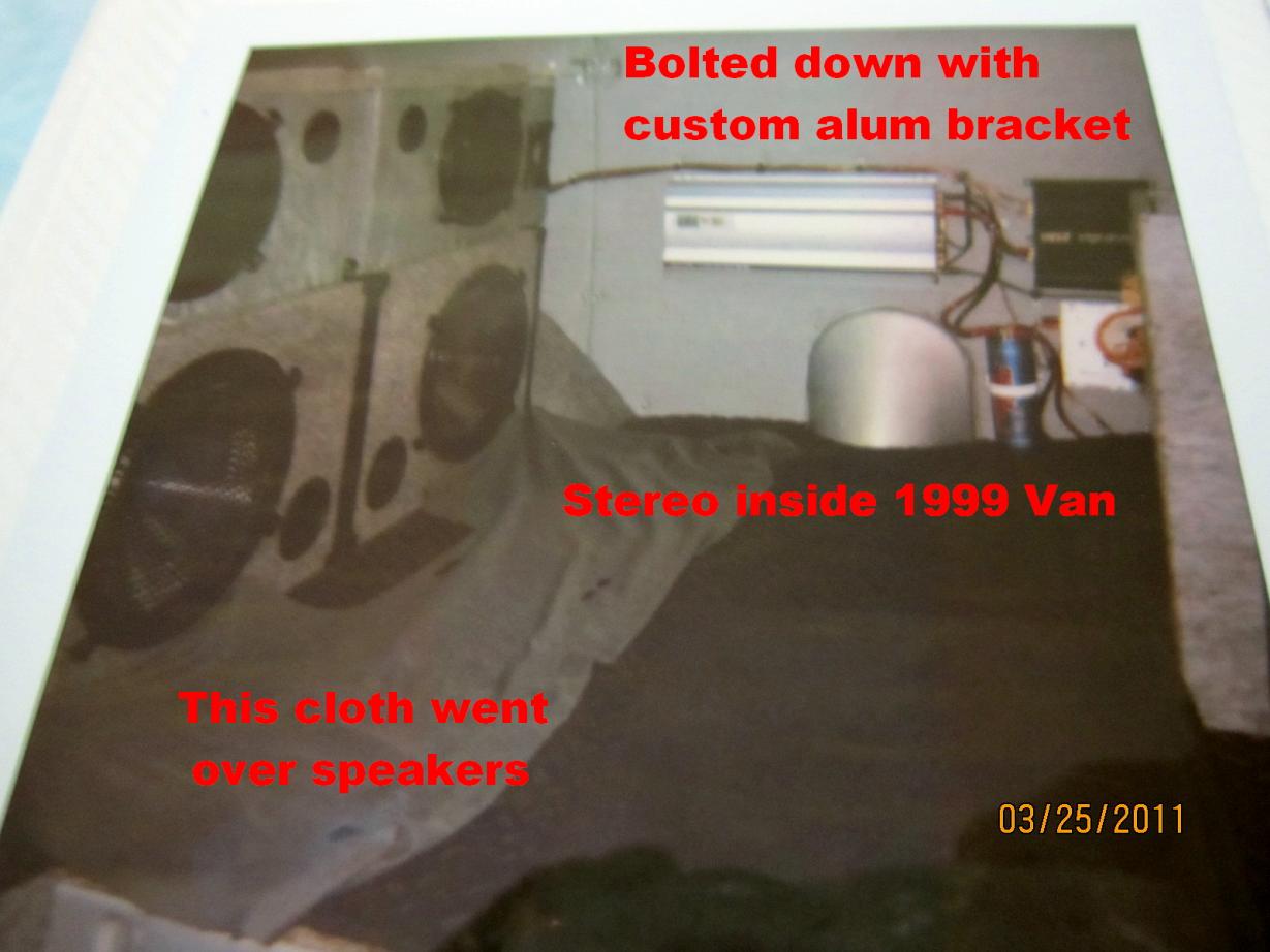

The Mazda 5 is basically a Van. The sides are not insulated, and probably not the bottom or roof. I had a Van once. I insulated the roof, sides and floor. On the roof and sides i used insulation and 1/4 plywood covered in material as my sides were totally unfinished (mini cargo van). On the bottom, I put some insulation as well as a thick piece of rubber. If your's is finished, you could pull off part of the panel and get some low spray expanding foam to spray walls and roof. I had to do this to my Mazda 6 wagon as there was some insulation but not enough to keep the rood from vibrating with the bass, after spray foam, no more rattle. Are wheel wells insulated (right above tires)? This is where some kind of extra insulation will be of a benefit.
The picture of my van is bad as it was before i got a digital camera.
