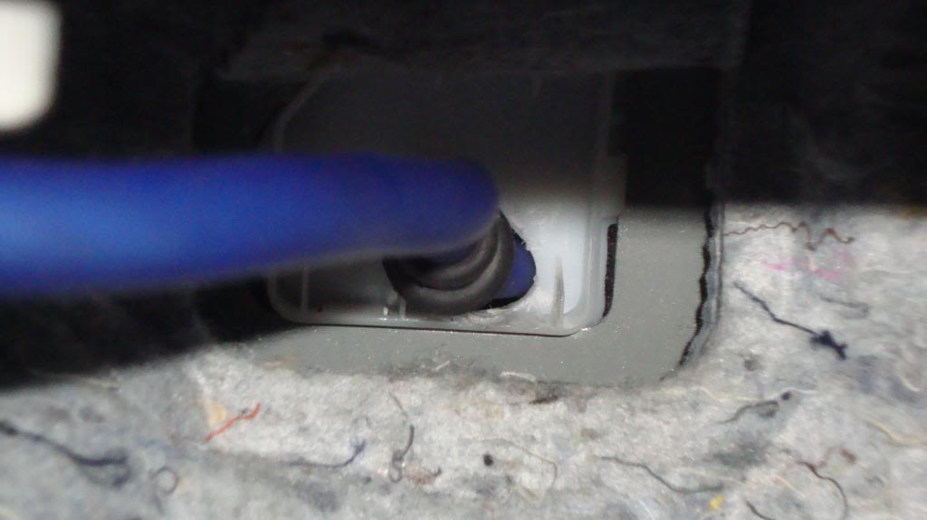

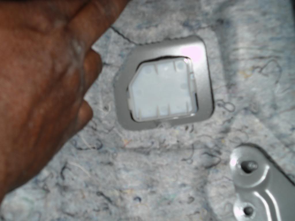

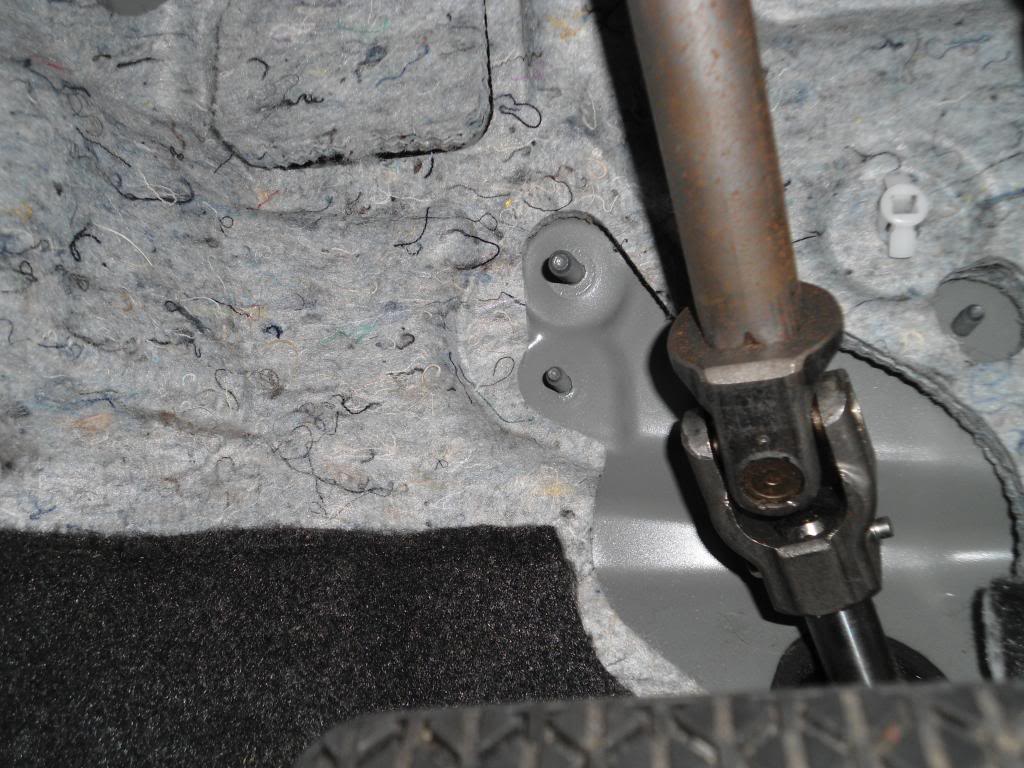

I took the battery out and loosened up the tray and was able to see the the white cap that bracedeunos and joe mama mentioned. it is just to the left and under the brake booster. Also from the inside, you can access the rectangle hole which is actually hidden behind the insulation. If you look you can see the outline of the rectangle embossed in the padding. Also, Mazda was nice enough to pre-cut it so it opens as a flap from the bottom and sides. Oh, I did take a picture of it~~~~>Name:  DSC06515.jpg
