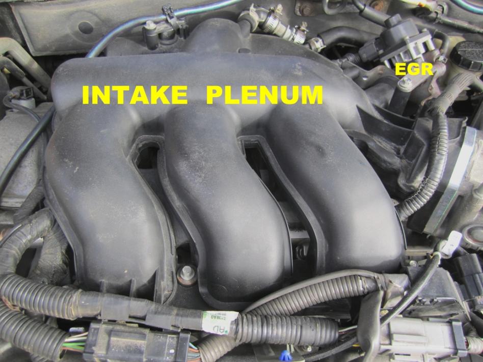

You should remove the intake plenum to change spark plugs by firewall. Disconnect ground wire on battery (it also will re-set your ECU which is required with all the changes you are about to do). Remove cosmetic piece of plastic engine cover.
First remove Mass Airflow Sensor, then accordian tube (inspect for cracks), then throttle body (now would be a good time to clean MAF and throttle body).
Unbolt EGR valve, carefully remove wire harness attachments from intake plenum, loosen bolts from plenum (they don't lift out, they stay with plenum). Clean plenum.
When re-attaching please change the following gaskets/seals:

PICS are from my 2006 car: Mazda Forum - Mazda Enthusiast Forums - UseYourNoggin's Album: Intake Plenum & PCV Valve. 2006 Mazda 6 V6 3.0 ltr.. Good time to change PCV valve as well (easier now with plenum removed). Inspect vaccuum lines.
Ignore my throttle body gasket as it is an extra one due to my Steeda throttle body spacer (yours does not look like it, click on link supplied)

Some people would not change, however I personally think there is enough mileage. Your pre-cats depend on a good running car. Once problems start (like misfires, bad PCV) then pre-cats are more of a concern because they don't like oil or misfires. Change the throttle body seal & plenum (6) seals. This is preventative maintenance to ensure a good running car. Driving around with problems, and waiting a week to get it properly looked may cause damage (I am not a believer in that especially for these items).
I actually did the work myself. I would say 2-3 hours max. I did not torque bolts down, but did not overtighten them either (hand tighten).
Do not remove throttle body from engine, unbolt it clean it, and let it hang there catching all the fluid with paper towels (do not force moving it).
I would also do this while you are there: EGR Modification/Optimization: - Mazda 6 Forums : Mazda 6 Forum / Mazda Atenza Forum
At the bottom of the first post it also does give you torque specs.
It also gives you step by step instructions on intake plenum removal.
Last edited by UseYourNoggin; Feb 16, 2012 at 02:35 PM. Reason: EGR MOD, torque specs
More data: recommended plug is w/ platinum tips. Service interval is 90K mi, they say. There is a T fitting from the radiator w/ coolant in it, small rubber tubing runs low right near the side of the battery. Advice is to be very careful here disconnecting as is easy to break this plastic thingy, and then you are back to buying more parts.
So the story is a shown by UYN above: take off a whole lot of stuff from the engine top, and be careful doing it. You gotta dig for those three plugs.
