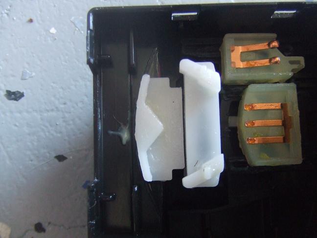

The offending broken piece is this white part I believe.
In theory that piece needs the have a wire, zip tie, etc. wrapped around it because it's separating too much. I haven't done the repair myself as mine still works fine, so I'm just going off of memory.
Once you open up the stalk module it should be pretty evident. I think what the issue is is the left side is supposed to pop back into center position, and the little arrow on it fits into a white piece on the stalk itself and centers it. Once you splint it up it should have enough tension to work again.
If all else fails you can replace the entire module. I believe it's about $80 from the dealer (check with Jason at onlinemazdaparts for the part number for you car, or e-mail him at mazdapart@gmail.com), or you may be able to find it out of a junked 3. Just make sure it's the one you want, as there are different stalks depending on if you have auto lights, fog lights, etc.
