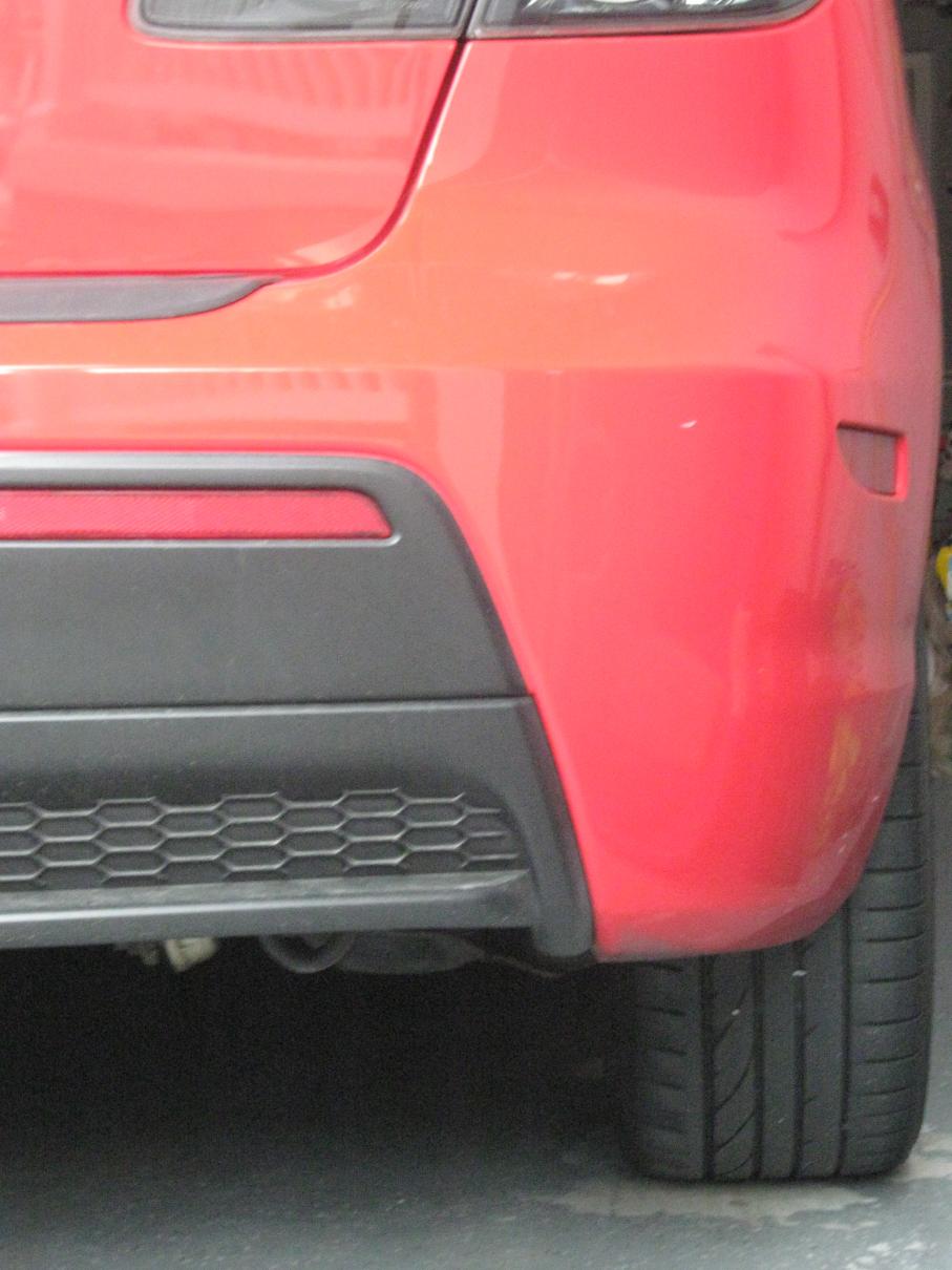

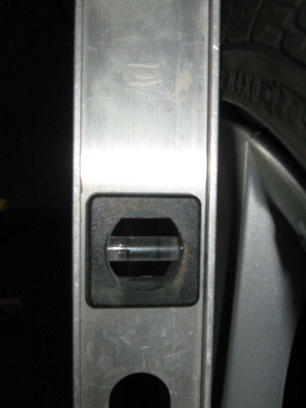

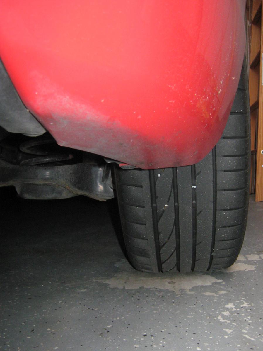

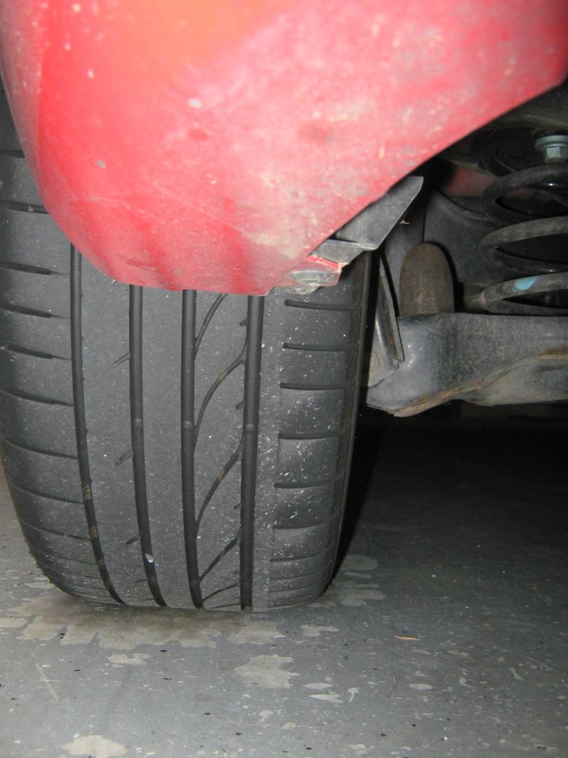

Do we know for sure that Virgin1's "cure" was the new arms and not different tires? I have factory original rear arms which are identical to the ones on your car and I'm able to get nearly 50,000 miles out of a set of tires, albeit better tires than what Mazda put on the car at the factory.
Another thing to consider is that you have a MazdaSpeed3 with high performance summer tires, tires with a 140 treadwear rating, and tires which would be lucky to see 20,000 miles on any car from any manufacturer. The tires which Richard and I are running sport treadwear ratings of 500 and higher. It's hard to stress this enough, you really need to look at the tires before you mess with the control arms.

Here are a few pix - you can see each rear tire is running hard on the edge and cupping on these rears that were rotated from perfect wear is clear after about 4,000 miles. I put a level to the rim and while it is hard to see, the bubble is all the way left holding this to the left rear wheel. I'll try some harder compound - any suggestions for longer lasting rubber that's also solid for performance?
Assuming your tire size is 215/45 R18, my short list would include:
  1. Yokohama AVID ENVigor (A set of which arrived for my Mazda3 yesterday)
  2. Continental ExtremeContact DWS (The tires Richard is running on his car)
  3. General G-MAX AS-03
  4. BFGoodrich g-Force T/A KDWS
I would also recommend the Michelin Pilot Sport A/S but that particular tire isn't made in your size.
