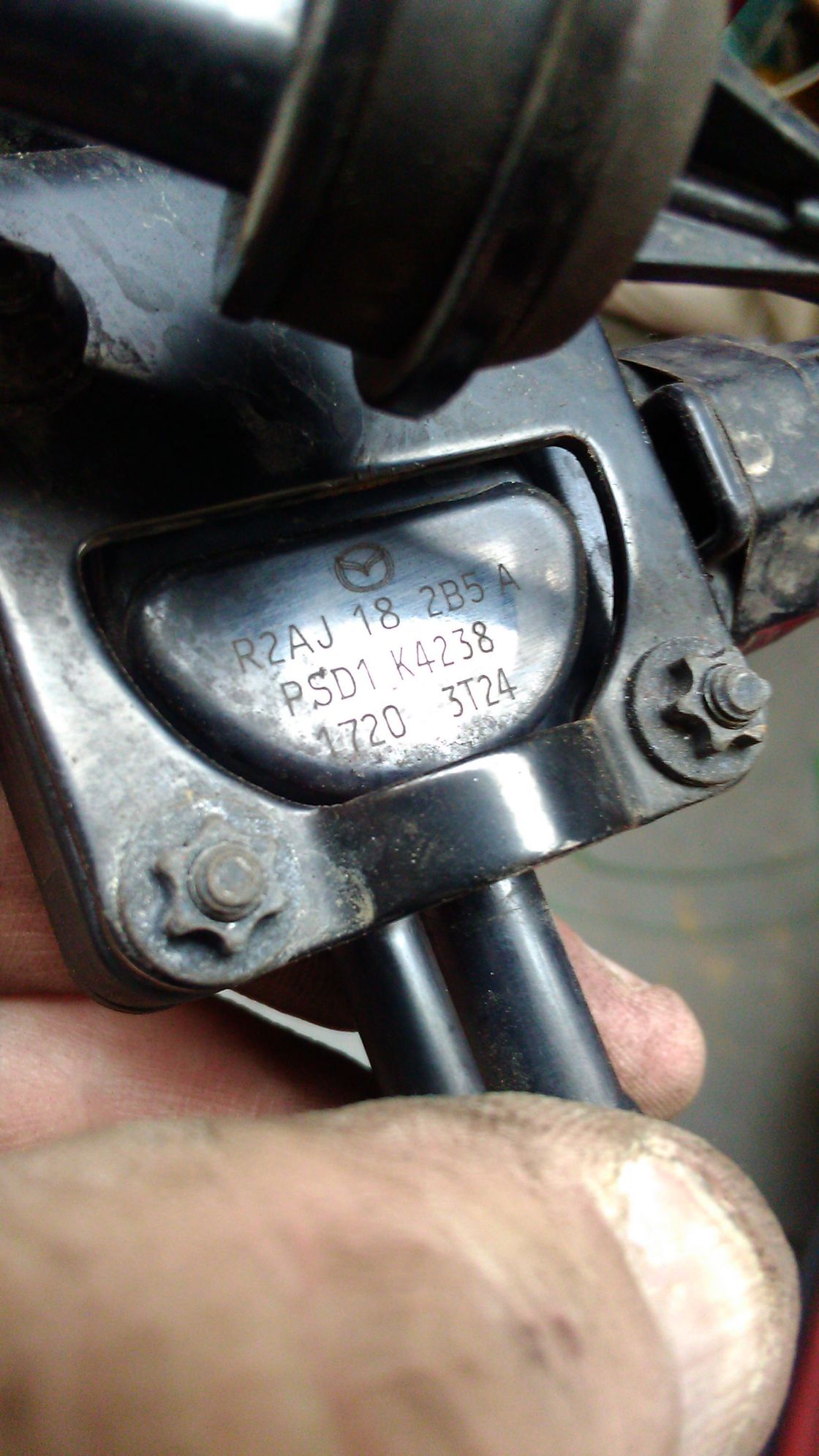

New exhaust fitted
Fault codes
The reading from the sensor shows 100% even after swapping out sensor
Swapped out the exhaust pressure sensor
And done the wire and diagnostic reset as well. Wanted to know other peoples opinion and see if I have missed anything
Dropped oil and new filter in as well
Mil light is on as well as a solid dpf followed by flashing dpf
Thanks

Yes I tried all the combinations of the manual wire to ground reset including 10 presses. 5 presses and finally the 2 press force regen. I'm not a novice been on the spanners for 20yrs jaguar for and vw trained Just the codes keep pointing back at exhaust pressure sensor. No amount of cleating the codes either via obd or earth cable seem to work

All codes reset. All environmental data reset. Trued both manual 2 pumps force regen and also obd force regen still no joy. Cleaned egr out. Cleaned maf sensor and another one I found on the manifold. Replaced the ambient air sensor and exhaust pressure sensor with £280 supplied Mazda part. Apart from throwing it all in the bin what else can I try?

Changed The rubber pipes from dpf pickups. And the additional pipes to sensor also flushed the metal section on the engine block so defo not that there all clean
