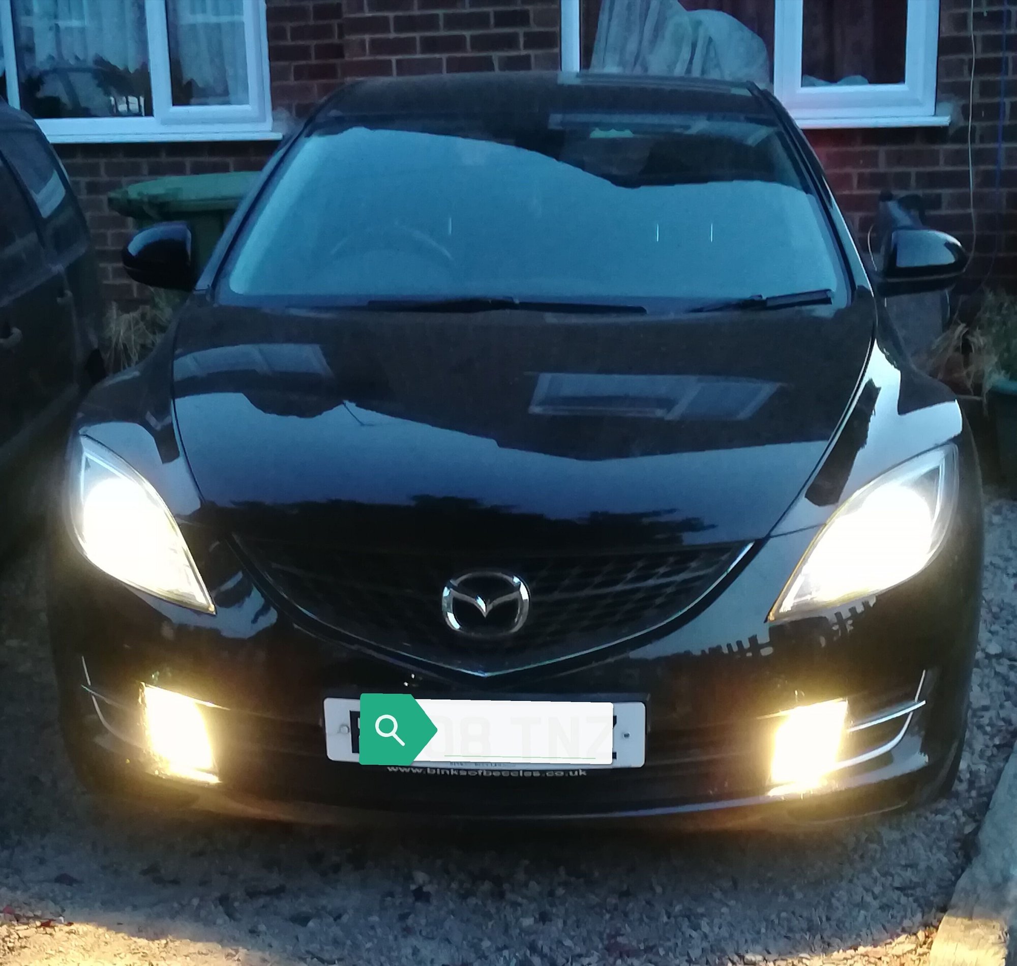

Hi and thanks for the reply i have had a new dpf fitted today (a friend has his own garage) and i have exactly the same fault as before.
Baffled and a tad anoyed this beautiful looking car is starting to become a bit of a pain.
