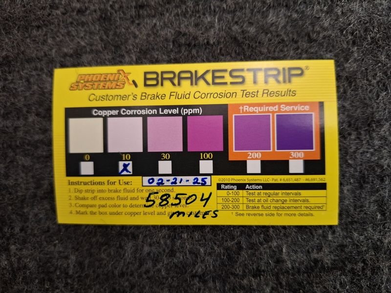

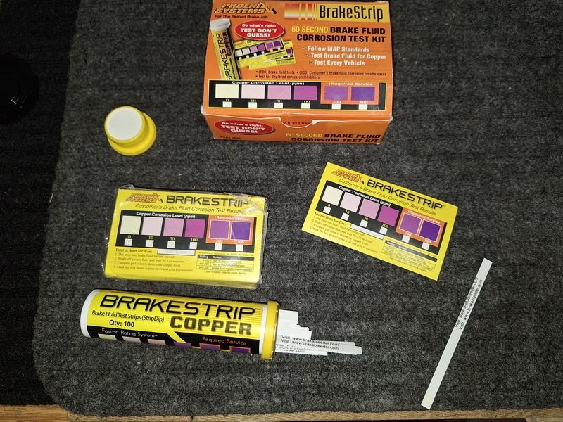

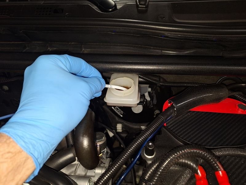

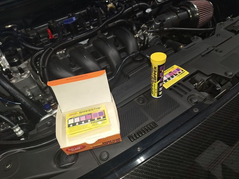

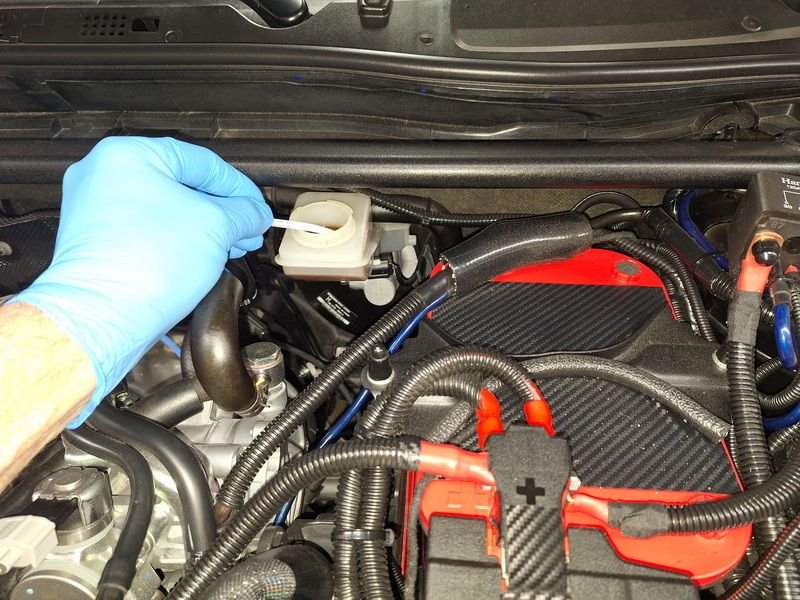

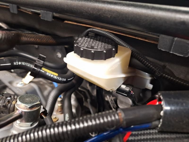

I used a suction tube and emptied the brake fluid from the reservoir and replaced with new brake fluid. I will do a complete brake fluid replacement another day.
