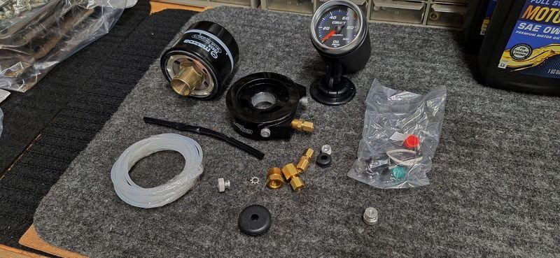

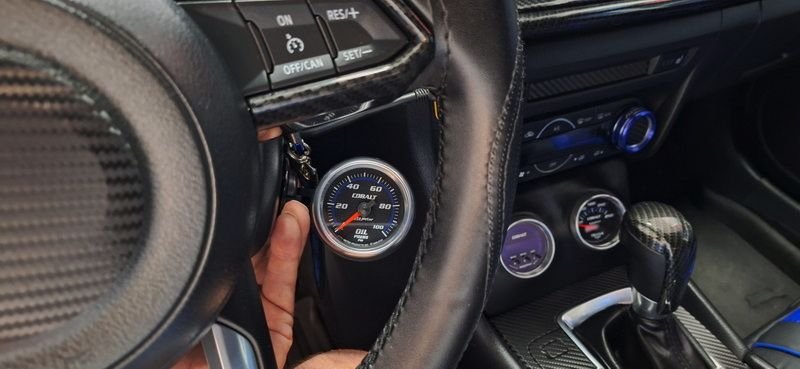

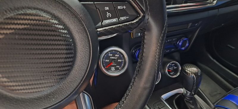

With a lot of chit chat on Mazda forums about oi specifically oils consumption related problems I decided I was done with having to use adapters to check mine. The ECU does not have a PID to register oil pressure so like most all Mazda you ned to use and adapter and T into were the oil pressure sender goes in order to read oil pressure. I will be installing a AutoMeter Cobalt series mechanical oil pressure gauge to match my other Auto meter gauges. it will have its on housing and mounted somewhere under the steering whell but in clear sight but not obstructing or looking to out of place. There is just not too many places to mount aftermarket gauges other than the pillar that don't look "add-On. While I do like pillar mounted gauges the coat to make a custom pillar and then Hydra coat it is not really what I want to do. so, under the steering wheel is where it is going.
