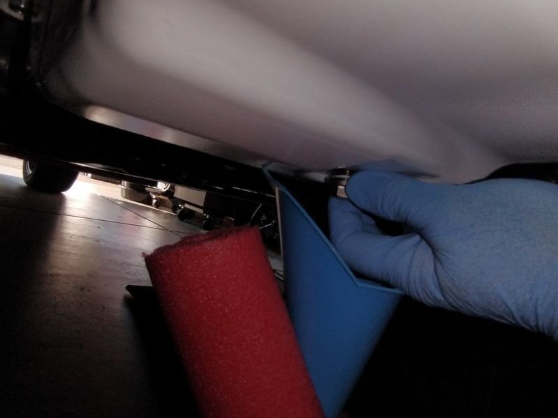

Yesterday was my 3000 mile engine oil filter and fluid and my 5k mile transmission fluid change and check.
I like that I have a forum record detailing all the required servicing. Just in case!
Nothing really new that I have not posted in the past. I will have other service upkeeps later because it just got to hot to do anymore work in the garage.
The transmission fluid looked as clear red as when I did my first service. The pan magnet had virtually nothing attached which is always a nice indicator that nothing serious is going on. I will do a complete pan gasket and fluid change at the next interval in 5k miles and have it analyzed at Blackstone Labs. One point of notte I do not use any gasket sealer and as you can see from the pictures (and my trans pan is white ) no leaks. There is one bolt that does require seal on the threads and that is even noted in the FSM

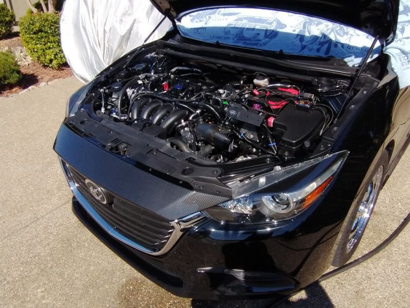

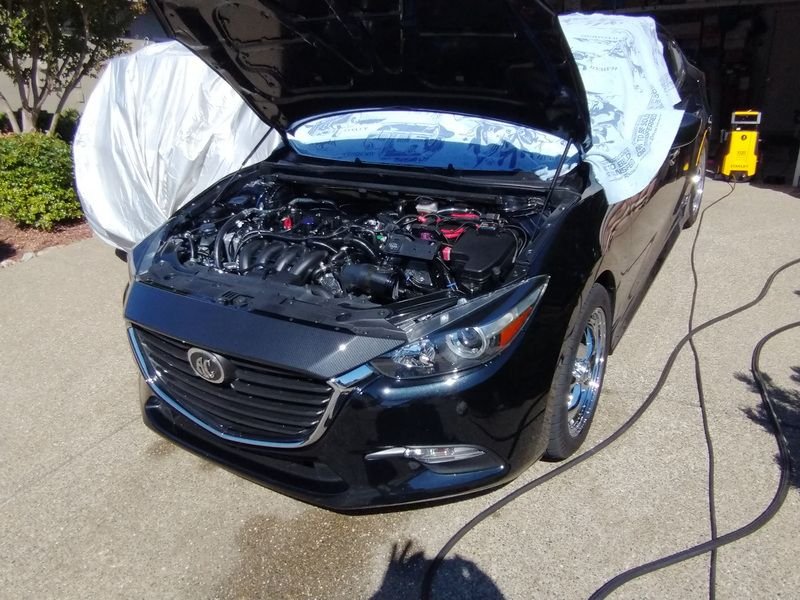

Washed the engine today. It was long overdue. I started seeing dust on my valve cover in some resent pictures I took and was going to post about how to check the engine oil level. I didnt post them for that reason.

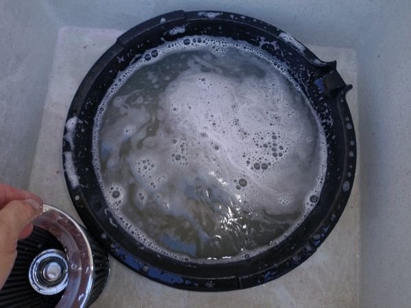

I also cleaned my K&N air filter. You can see in the pictures how the water turned dirty in color indicating the filter was doing its job. While I was at it I also pulled the Cabin filter and re-installed the K&N for the summer months because of using the AC more often now that we are getting 100F plus degree days here.

This is the rinsed water after cleaning the filter to make sure it was clean before drying to apply the new oil.
I apply onne full coat of oil and wait for about 10-20 minutes and then touch up any area's that are still showing white material I missed during the initial oil spraying.
Reassembled the seals and installed back on the engine.
