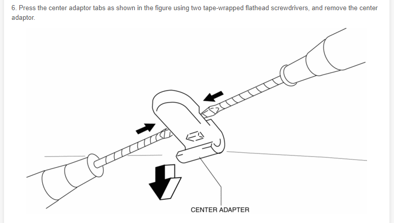

So, my question is, how do you release the Sun-Visor Clip, which secures the Lining?
It looks like it has a piece that needs to be slid out to unclip it, but no amount of prodding does it.
EDIT; Found it!!
